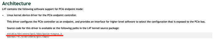

Then, I tried to follow the doc, NVIDIA JETSON AGX XAVIER PCIE ENDPOINT SOFTWARE FOR L4T(released May 1, 2019).
There are two questions here:
  1. On section 1.3, it says " All commands described in this application note must be run as root. Some commands use shell I/O redirection, and will not operate correctly if run using sudo." What does the last sentence mean? All I know is that if I want to run as root, I need to use “sudo”, not sure why using “sudo” can be incorrect if we still want to run as root.
  2. On section 1.4, in step 1, the ODM data in the extracted L4T release directory needs to be changed. My question is where the L4T directory is. As I can check my L4T version, I thought I should already get the L4T directory, but I am not sure what keywords I should use to find it, not sure where the folder exactly locates. Although in section 1.1, it mentions “nvidia/drivers/pci/dwc/pcie-tegra.c” and “kernel-4.9/drivers/pci/dwc/”. But I am still not sure what the absolute path is for L4T directory. And I also ran "sudo find pcie-tegra.c"under my desktop folder, i.e. /home/my_hostname, but got message “No such file or directory”.

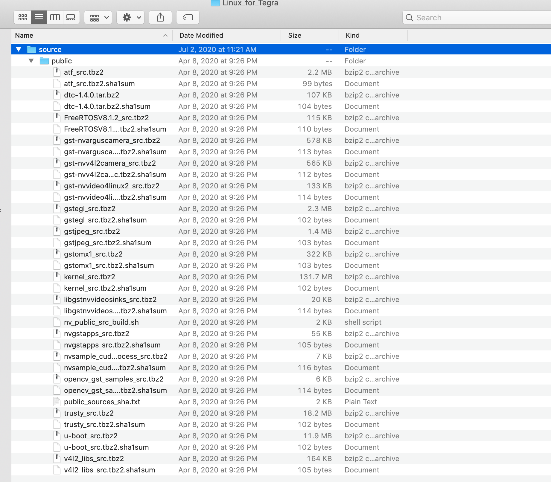

Hi WayneWWW,
Thanks for the reply. I have checked the host machine, but found
  1. I dont have Linux_for_Tegra folder
Not sure whether I actually need to download L4T.
So I downloaded L4T source, but in the downloaded L4T, I have following directory:
where I didn’t find file. p2972-0000.conf.common
Not sure which step I did wrong.
  1. I have one folder, called nvidia on host machine, which seems related due to this information
    But in my nvidia folder, I only have sdkm_downloads. Not sure whether this is what should be expected.
Have you ever installed your jetson with SDKmanager ever once? I mean to complete the installation of your board so that it can boot into ubuntu OS.
I guess you got misled by the file name. Sorry that I don’t know the public source would also have “Linux_for_Tegra” too.
Below is my path to the file you need.
~/nvidia/nvidia_sdk/JetPack_4.3_Linux_P2888-0060/Linux_for_Tegra$ ls -al p2972-0000.conf.common
-rw-rw-rw- 1 waywang waywang 8268 Dec 10 2019 p2972-0000.conf.common
Please note there is one line just prior to the pcie-tegra.c and pointing out it is in “l4t kernel source”.
So pcie-tegra.c is actually in the first screenshot of your file.
Also I notice you are using mac as host OS… SDKmanager does not support other OS but only ubuntu.
Actually, what you need to do is just flash your board with sdkmanager once. Then, your host will have Linux_for_Tegra and p2972-0000.conf.common. No need to worry about where is tegra-pcie.c at all. You could read the document and the document does not give you any instructions on pcie-tegra.c at all.
This is just the driver code for someone who wants to refer to.
