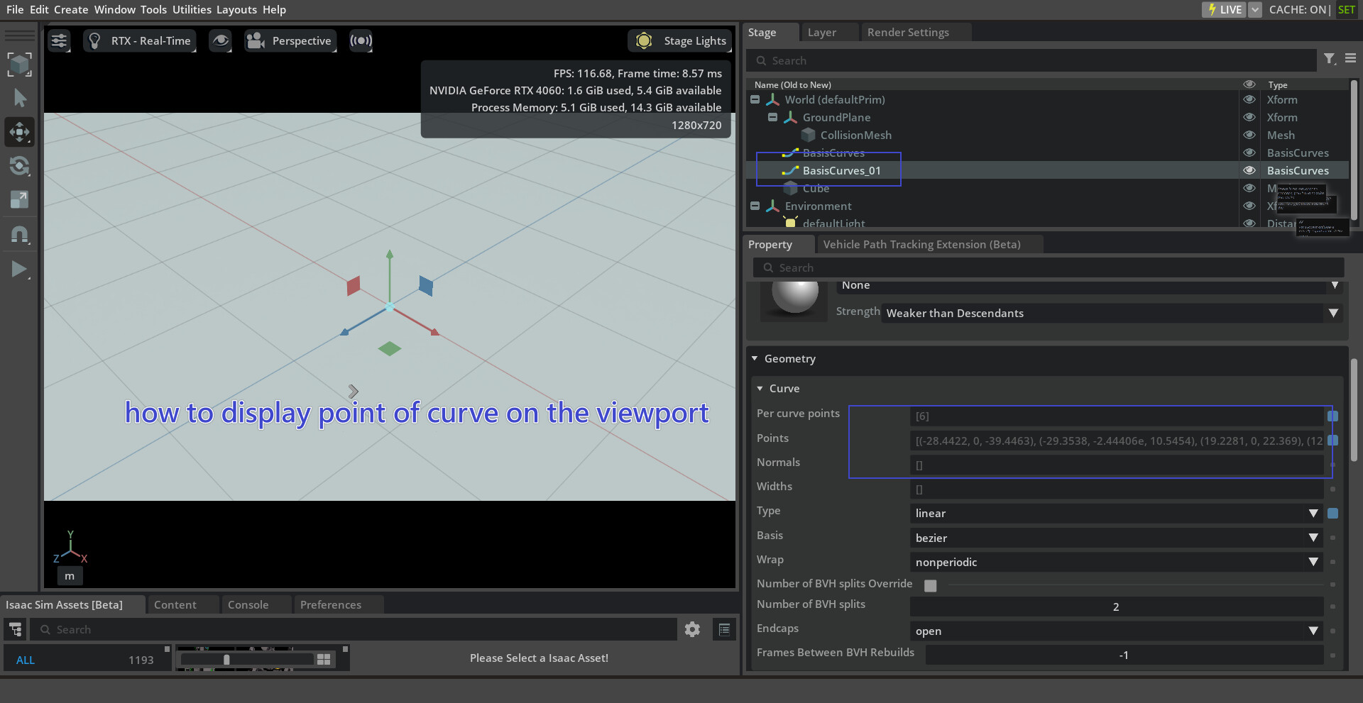

hi,
as the image and title describe
i had created a curve, and there are some points in curve property
however, i can’t see the point in the viewport.
want to know is there any setting i missed? thanks!

@yuchunlin33 as another user, i don’t believe you missed any steps; this default behavior has been my experience since i started using Omniverse/Kit. the vertices on curve prims will only be displayed if you are in the vertices editing mode.
the video below shows how you can access the editing UI using Isaac Sim 4.5.0 (kit 106.5) on Windows but shouldn’t be much different in other kit builds:

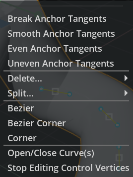

P.S. when in vertices edit mode, you can right click on selected CVs to control tangent types if needed.

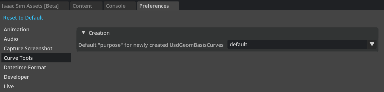

P.P.S. if you find yourself working with curves a lot and want the Purpose
set to a certain mode by default upon creation, you can make the change in the Preferences
menu:
