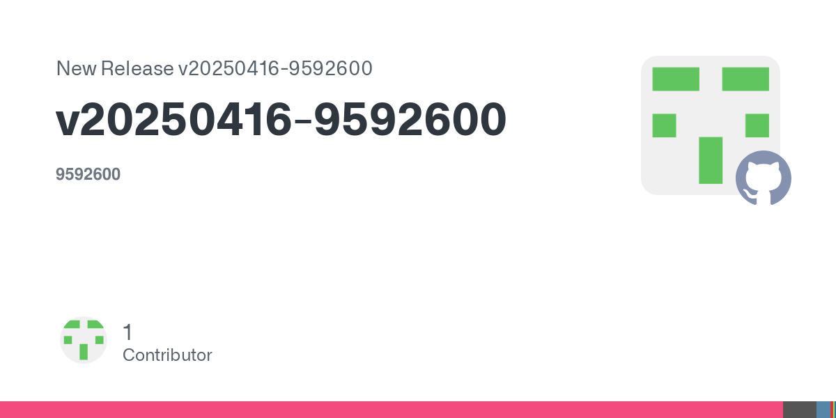

I CI Pushed appimage for armv8.0a test, but only run under Ubuntu 24.04 due to glibc.
