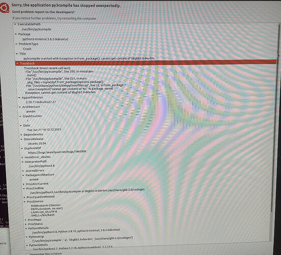

Hi Team
I recently got a red prohibition flag error showing that : the application py3compile has stopped unexpectedly.
The whole error shown like this:
I’ve try to sudo apt --fix-broken install but got the following error:
And I can nether install python3-minimal or ligblig2.0-dev-bin. Cannot do sudo apt-get update either.
Does anyone have ideas how to fix this broken pacakge? Thank you in advance for your time and help!!!

Some updates:
I also get: hwe-support-status crashed with FileNotFoundError in_execute_child(): [Error2] No such file or directory: ‘lib_release’
I feel like my whole python get crashed in ubuntu. Is there any safe way that I could reinstall it? I could still run the code successfully, do I need to reinstall Image to Jetson orin?

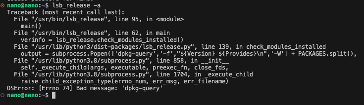

Hi Aasta, thanks for replying.
Here is the command and according output I got:
jtop (it used to be work but now it will keep showing following thing:)
lsb_release -a
sudo apt --fix-broken install: it works now after delect broken package and reinstall all of them
sudo apt reinstall lsb-release
lsb_release -a
My os detials:
So currently, the problem is I cannot run lsb_relase -a and jtop, even I reinstall lsb-release and fix-broken install.

I solved the jtop issue by open the /usr/bin/lsb_release and edit the firs line to be " #! /usr/bin/python3.8.16 -Es " which used to be python3, and python3.8.16 is the current virtual environment I’m using. But actually I do not have this python3.8.16 folder… …
However, lsb_release -a keeps showing this, even I reinstall lsb-release and dpkg and --fix-broken
Is that because pyhon3 was broken?
