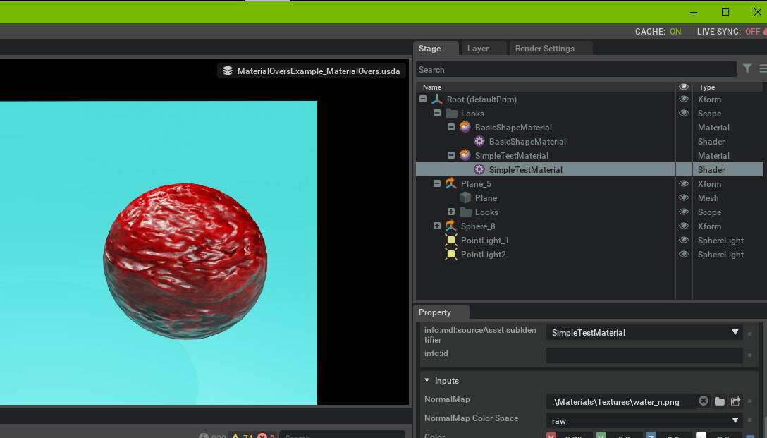

I’m not 100% that my example will properly address this issue, but I thought I might share it. I’m doing this:
  • I created a material in Unreal with a few parameters that you can override once you export them as USD/MDL.
  • If we use the Create a material overrides sublayer the Unreal USD/MDL exporter will create USD materials and reference them in an overs layer that demonstrates what I think you’re asking about
  • I opened the USD stage in Create and set the edit layer as materialOversExample_MaterialOvers.usda - then I edited a couple of the parameters in the two exported materials. The materials are referenced as overs, if you like you can duplicate these to generate lots of different materials with different parameter values:
        def Material "SimpleTestMaterial" (
            prepend references = @./Materials/SimpleTestMaterial.usda@
            over "SimpleTestMaterial"
                float4 inputs:Color = (0.32999998, 0, 0, 0) (
                    customData = {
                        float4 default = (0, 0.796875, 0.037067, 0)
                    displayName = "Color"
                    hidden = false
MaterialOversExample.7z (1.5 MB)
