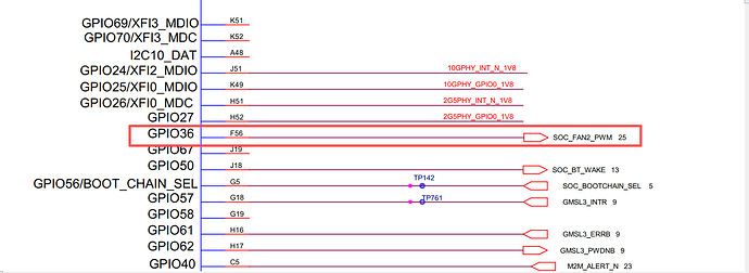

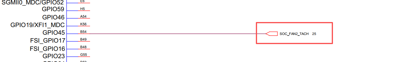

We have added a new set of PWM and combined it with the original PWM to form two groups of fans. The system’s built-in one is quite useful. I want to add a new control to adjust the fan speed based on a temperature strategy.
This gpio36 is used in the schematic diagram
two pin one is gpio36,one is gpio45, How does the code use these two pins
Hi mingming,
Are you using the devkit or custom board for Thor?
Please refer to the pwm-fan node in device tree which has configured PWM4(pwm@c6a0000) for FAN by default.
In your case, it is PWM3(pwm@810c5f0000) and you can configure the same.

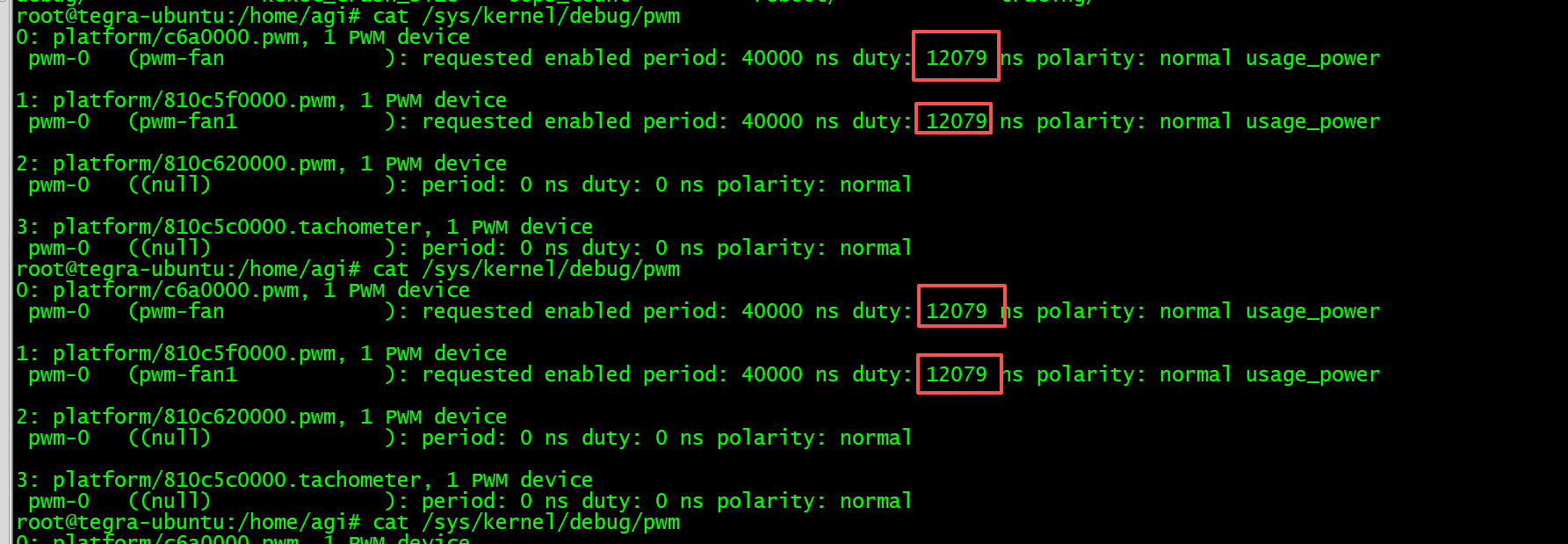

we use custom board for thor.
now i configure the pwm3,one problem is that the fan speed is a fixed value and will not change.
I see that the fan in the original pwm4 channel has changed.

hi:
this have two pwm,pwm3 the duty cycle of pwm is now fixed and does not change with temperature variations
Will the pwm3 get changed if you control it through sysfs node manually?

I found that we are not using this gpio of pwm tach now. Could it be related to this
Do you want to add another FAN to be controlled according to the temperature?
If so, you have to add it into nvfancontrol_p3834_0008_p4071_0000.conf for nvfancontrol.service.
FAN tach is used to measure the FAN speed.(i.e. rpm)

hi:
agi@tegra-ubuntu:~$ ls -l /sys/class/hwmon/
total 0
lrwxrwxrwx 1 root root 0 Feb 22  2025 hwmon0 -> ../../devices/platform/bus@0/a808440000.pcie/pci0003:00/0003:00:00.0/0003:01:00.0/nvme/nvme0/hwmon0
lrwxrwxrwx 1 root root 0 Feb 22  2025 hwmon1 -> ../../devices/platform/pwm-fan/hwmon/hwmon1
lrwxrwxrwx 1 root root 0 Feb 22  2025 hwmon2 -> ../../devices/platform/pwm-fan1/hwmon/hwmon2
lrwxrwxrwx 1 root root 0 Jan  1  1970 hwmon3 -> ../../devices/platform/bus@0/810c5c0000.tachometer/hwmon/hwmon3
lrwxrwxrwx 1 root root 0 Feb 22  2025 hwmon4 -> ../../devices/platform/bpmp/bpmp:i2c/i2c-5/5-004c/hwmon/hwmon4
lrwxrwxrwx 1 root root 0 Jan  1  1970 hwmon5 -> ../../devices/platform/nvtherm-oc-event/hwmon/hwmon5
agi@tegra-ubuntu:~$
agi@tegra-ubuntu:~$ sudo find /sys -name "name" -exec grep -l "pwmfan" {} \; | xargs dirname
/sys/devices/platform/pwm-fan1/hwmon/hwmon2
/sys/devices/platform/pwm-fan/hwmon/hwmon1
agi@tegra-ubuntu:~$ sudo find /sys -name rpm
/sys/kernel/tracing/events/rpm
/sys/kernel/debug/tracing/events/rpm
/sys/devices/platform/bus@0/810c5c0000.tachometer/hwmon/hwmon3/rpm
agi@tegra-ubuntu:~$
It seems both pwm-fan have been configured and enabled correctly in your case.
What do you mean about “定值”?
Please share the result when you run sudo nvfancontrol to start the daemon.
hi:
What do you mean about “定值”? —-》By reading the entire pwm node, I found that the values were the same,this value reflects the rotational speed of the fan
