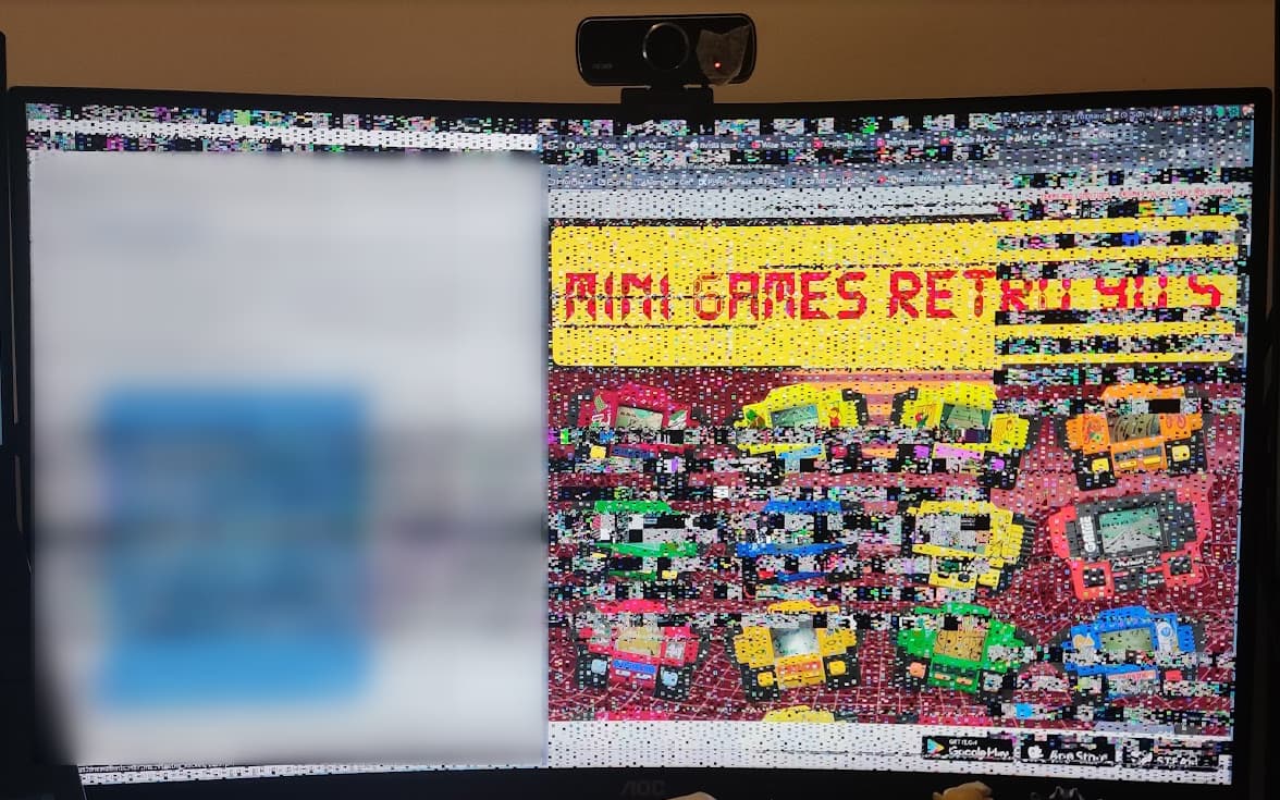

Random crashes on wayland since driver 580 on Linux
General information:
Distribution: Arch Linux
Kernel: 6.16.7.arch1-1
Driver 580.82.09-1, nvidia-dkms package (not the nvidia-open driver)
GPU: RTX 3070 Laptop (110w)
Since driver 580, I’ve hit a regression that after about 1 hour of activity on any Wayland-based interface (tested with hyprland and sway), my laptop will freeze without further logs to the point I have to force poweroff by holding the power button. Nothing on journalctl -b -1
The 1 hour mark is an average, but this error sometimes reproduces at the 20 minutes mark, or at the 2 hour mark, and it does not even needs to involve GPU load with 3D games. Just normal web browsing and routine tasks may trigger it. Disabling the nvidia-powerd.service will make the system more stable and not crash under the 10 minutes mark, but it will eventually crash.
Important: It does not reproduces on X11even if I deliberately put load on the system and spend hours logged. Some of the pictures I’ve got.
hyprland, yesterday night after 1:45h of use:
sway, past week after 2h of use(same artifacts but since there is some personal data at the left I had to blur it with before posting here).
wayland periodically entirely crashes since installing 580.82.09, every application quits and I need to restart the whole session, its odd.

memtest_vulkan indicates that there is no memory issues with my GPU as well, and no crash was triggered so far since I started using nouveau on my laptop.
Are you still experiencing these issues?
Yes.
Drivers 590 is still didn’t fix a thing. Random freezing without any extra dmesg log, with disk activity led turned fixed on (no blinking) .
The weird artifacts are not happening anymore, but now, the computer is just completely frozen and a long power button press is needed.
I have tested out the GPU load with software, no issues on multiple benchmarks, used memtest.efi and made a long smartctl test to make sure that it isn’t something with memory and disks, and also, used stress-ng for the CPU. All of them passed.
The only thing left is the nvidia-open driver that after version 570 just became utterly crap.
Edit: Another thing. It’s been 2 months that I’m using the RTX3070 exclusively and I have put my laptop in Ultimate(Dedicated) mode because I thought that Optimus could be part of this equation here but, in ultimate mode it is still happening :(

Have you tried cleaning the GPU fans, replacing the thermal paste, and raising the laptop’s back with attachable legs?
Have you tried using a version of nvidia-open-dkmsthat doesn’t contain the 0003-Revert-a-change-related-to-the-display-stack-in-580..patch?
For example the one in the Express Repository?
Did the cleaning already and also, replaced the CPU and GPU dyes with PTM7950 and the GPU vRAM with some Upsiren thermal putty. Temperatures are great and thermal dissipation and management is better than what I’ve had with thermal paste which was really dried out when I replaced 10 months ago. I try to run maintenance once each year on my laptops.
I’ll try the dkms after the battery replacement, to isolate all the variables.
Regards,
Temperatures monitoring aren’t reliable, because CPUs and GPUs under performance tend to clock till reaching 95ºC under any circumstance. Also they tend to exclude the VRAM itself.
Only choosing the appropriate thermal solution, and mounting it properly does it.
The effects you are seeing could be very likely due to VRAM overheating or harm.
Also if the laptop has a charger, that can also be the culprit. Chargers lose conductivity over time, hence Watts, and may not provide enough power.
While this is a valid investigation path, this issue is happening even when Nvidia is under no load at all, and the laptop is running on battery for like 10 minutes only, with Firefox and 3 tabs…
Also, I have put this gpu under stress and sometimes I have hours of reliable use or 4h gaming sessions without any issue so, I do believe it is temperature related.
It happened on both situations: while on battery and while charging as well.
The only way to tell is by keeping swapping software and hardware components, and seeing if it still happens. Till you find the specific one that changes behavior.
