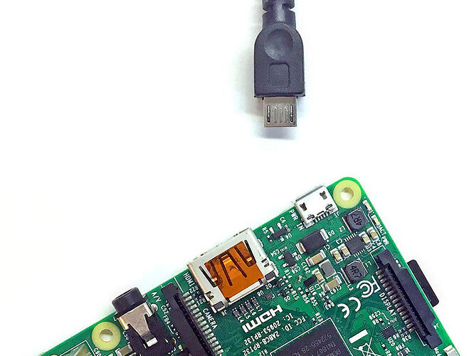

I’ve used two options in the past for SBCs, the most restrictive but efficient is making the SD card read only. This guide is for a Raspberry Pi but you get the idea:
Another more convoluted route is powering the board from a timed relay. The board itself listens on a GPIO for a loss of power to the relay and initiates a shutdown. By the time the relay powers off the system should be shut down safely.
Almost all the boards I run have this problem though, I’d love to hear what other people do to work around this problem!
