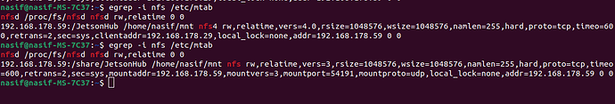

You originally had “fsid=0” for “/share/NFSv=4”. Maybe that isn’t even the export you are using for that part, but if it is, then that is likely the problem. What do you see for this from Linux side which imports?
egrep -i nfs /etc/mtab
I’d just like to establish the actual NFS import and export options (import might change something; export from the server, import from the mount side).
I tried it twice, once with NFS3 and once with NFS4, as I could now mount it in NFS4 but it seems to have the same issue at the flashing…
This is the terminal response for the command:
Does that have fsid=1 in the exports file? The import side won’t know specifically about that (which is what the mtab is…the mount/import side).

I think I figured out what the problem is.
It isn’t about mounting the Linux_for_Tegra Folder over NFS from the QNAP server; this works and is verified.
However, this issue has been occurring since the L4t_intrid_flash.sh script re-exports the rootfs and kernel image folders again, making them visible to the Jetson, which causes the conflict.
When I am commenting out the NFS sharing part from the scripts, the flashing is starting fine and sending blob to the Jetson and crashing again since the Folders are still not shared properly.
I’ve done some research on how to re-export NFS, which seems not to be possible or considered as a bad practice. My current solution that I will take a copy from the Server and run it locally, which isn’t the best case for us. If you have any clue how to overcome this, it would be perfect.
