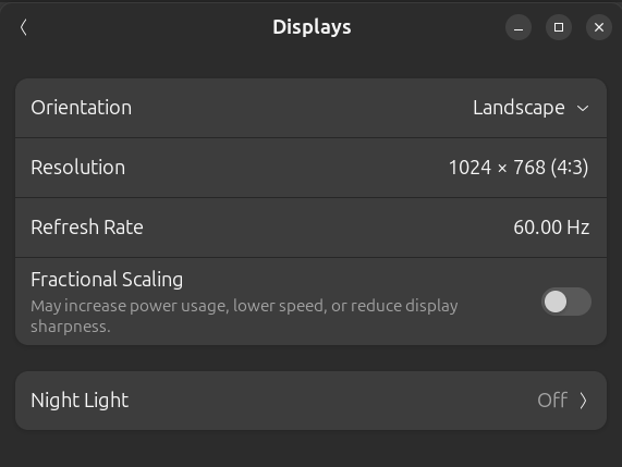

Issue with driver. System can not detect dual monitors, and also displays the resolution at 1024 x 786. See image.
See below for re-installation and terminal output.

Try adding nvidia_drm.modeset=1 when booting or make it permanent in /etc/default/grub
You have a lot of nvidia: Process '/sbin/modprobe nvidia-modeset' failed with exit code 1 entries in your log. Might try to figure out why is failing on your system.
I’m using RTX 5070 with driver 570.172.08 also, and while single display the resolution is as expected.
