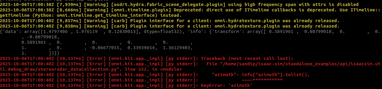

In Isaac Sim 4.5, it was easy to create an annotator “RtxSensorGpuIsaacComputeRTXRadarPointCloud” and use .get_data() to access the entire data from the sensor. But in Isaac Sim, the annotator got replaced with “IsaacExtractRTXSensorPointCloudNoAccumulator”, and if I do the same annotator.get_data(), I can only get the Cartesian points output. Is there any way to get the range, azimuth, and elevation values from the sensor in Isaac Sim 5.0?
Note: I have modified both the Example.json file and the radar attributes in the environment to 4D and FUUL_EL to get the full elevation data
Steps to Reproduce
  1. Create a Radar sensor either through a script or directly in the environment
  2. Create an annotator using the label mentioned above
  3. Use annotator.get_data() function to access the radar output
Error Messages
2025-10-06T17:00:40Z [10,137ms] [Error] [omni.kit.app._impl] [py stderr]: “azimuth”: info[“azimuth”].tolist(),
2025-10-06T17:00:40Z [10,137ms] [Error] [omni.kit.app._impl] [py stderr]: ~~~~^^^^^^^^^^^
2025-10-06T17:00:40Z [10,137ms] [Error] [omni.kit.app._impl] [py stderr]: KeyError: ‘azimuth’

Hi, did you find out how to access RCS or Power values? I also only get the x,y,z values from the IsaacExtractRTXSensorPointCloudNoAccumulator
Unfortunately, no, I’m in the same boat as you. I can only access the x, y, z Cartesian points and nothing else. If I try a different annotator, the output is just empty.
Finally, found a way to extract the azimuth, elevation, range and rcs information from the data. I have a attached a code below for your reference. Hope it helps.
