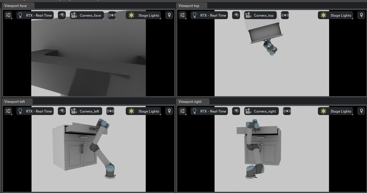

I have solved this problem now.
I have created some viewports from cameras of different angles by function create_viewport_for_camera after having cleaned the viewport default by function destroy_all_viewports. And in every update, i just run save_image()
def save_image(self):
    Save images from the cameras
    self.save_image_from_viewport(vp_name="Viewport face")
    self.save_image_from_viewport(vp_name="Viewport top")
    self.save_image_from_viewport(vp_name="Viewport left")
    self.save_image_from_viewport(vp_name="Viewport right")
def save_image_from_viewport(self, vp_name):
    vp_api = get_viewport_from_window_name(vp_name)
    file_path = os.path.join(self.demo_folder_path, f"capture_{self._action_sequence_index}_" + vp_name)
    capture_viewport_to_file(vp_api, file_path)
So the solution is keeping all the viewports active.
Note: you should make every viewport have his own window to display like the image below. If not, you will find that the images from only one viewport are saved.
