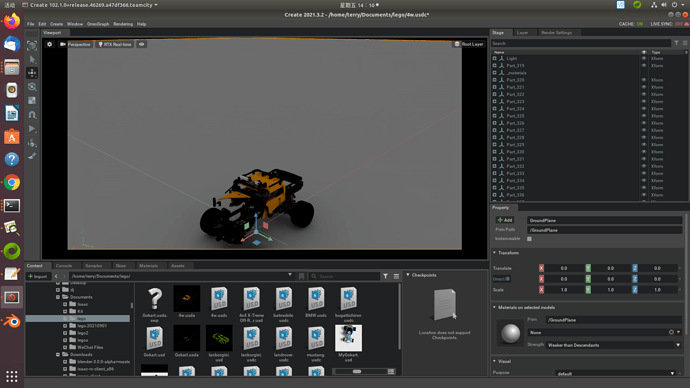

I have some lego bricks in .dae format, and use blender to covert to usdc, but after opening in omniverse, everything turns out too small, and cause the camera failed to view after scale to the level large enough to view. Any suggestion?
I find a solution, Blender has a option when import: ‘with unit’, with this chekbox on, the scale is working correct.
