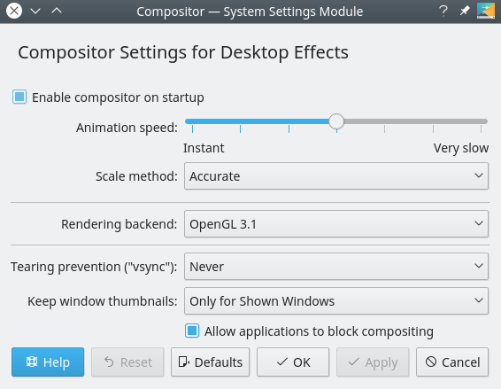

Could you confirm the compositor settings (“Rendering Backend”, “Tearing Prevention”)? Do you find that these settings influence the repro? I was not able to repro on KDE Plasma on Ubuntu 18.04 with the default settings.

Hello! I have OpenGL 3.1 as the backend, and I have Tearing prevention set to Never.
Attached is a screenshot of the compositor settings.
Note that in the Nvidia X server Settings dialog I have “Force Full Composition Pipeline” enabled.
It’s not very easy to reproduce the bug. I have to exactly time the “fading in” animation of the notification with triggering “show desktop grid” (Ctrl+F8 by default). It takes me at least 3 trials to reproduce it.

Thanks. I was able to reproduce the freeze when using the OpenGL 3.1 backend. I am however not able to reproduce it with the OpenGL 2.0 backend. Could that be a work around for you while we investigate this issue?
Unfortunately I tried switching the backend to OpenGL 2.0 and I could reproduce the issue the same way as described. I did it twice to confirm.
