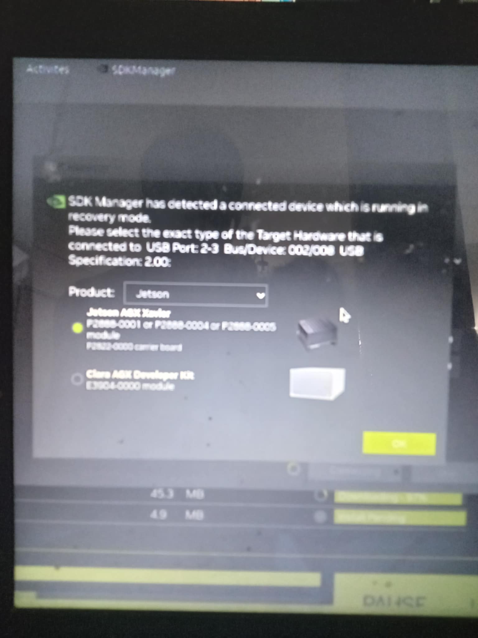

hello,
When I try to flash software on the Xavier, the board is detected (when I use the lsusb command), but the flash operation does not complete.

First, make sure you are following the correct steps to flash the Jetson Xavier AGX. Here’s a webpage with all the necessary information: NVIDIA Jetson Xavier AGX.
Additionally, you could try using a different cable or follow the suggestion from this post where they had a similar issue: The connected Jetson device is not ready for flash.
As mentioned there, you could also try disconnecting other unnecessary USB devices, connecting to a different USB port on your host computer, or even testing on a different computer.

Thank you very much! The issue was resolved after I used Ubuntu 20.04 and JetPack 5.1.5 with SDK Manager
