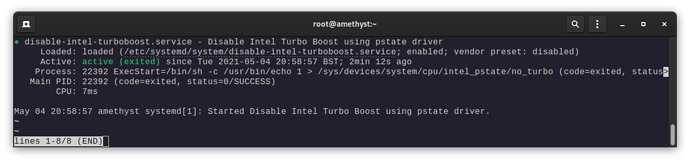

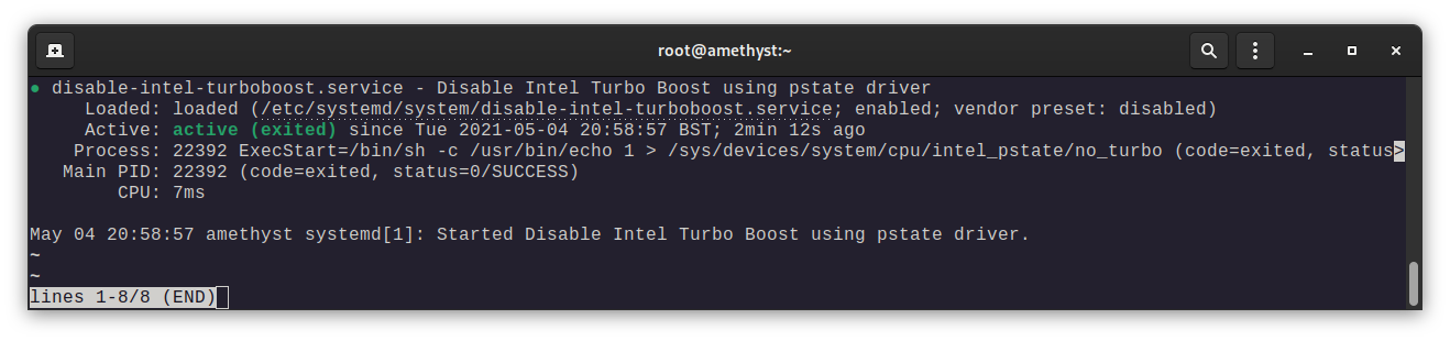

Disabling the CPU boost worked for me
To make the change permanent I followed these steps
I still won’t have access to the computer in question until April but I am absolutely not going to be using stock clocks, that’s not an option. I am not going to be giving up 30% of my CPU clock speed. My CPU overclock is entirely stable (can run 10+ hours of prime95 no problem) and my CPU has nothing to do with my display because it’s not a laptop, it’s a desktop.
