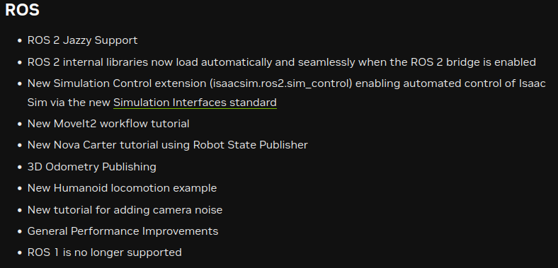

I have just noticed that Isaac Sim 5.0.0 has now officially implemented the 3D odometry.
I had not time to test it, but its worth to give it a try.
