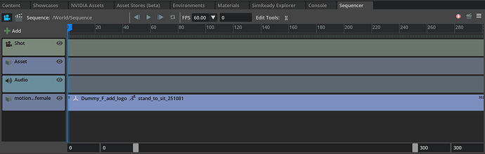

  1. When I drag a new character into the sequencer, the view range changes from 0->300 to 300->300. Its confusing as I often then drag an animation clip in, and wonder where it is. (Its dropped in at offset 300, which is after the end!)
Before - note the view range at the bottom has view start 0.
When I drag a new character into the sequencer (the left panel, under the “motion…female” text), it creates a new track correctly, but the view start offset is changed to 300 at the same time. Is that a bug? (It is at least annoying as I keep having to remember to reset the view range back to start from 0). (Many other actions do the same after watching it for a while.)
