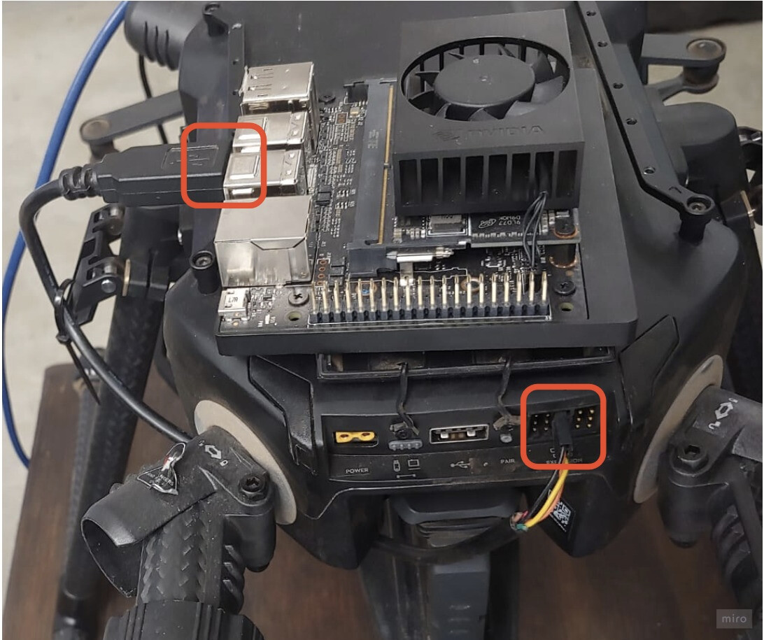

- We are connecting the Matrice drone through its UART extension ports to the Xavier NX’s USB-A port using a TTL cable

Here is our setup:
