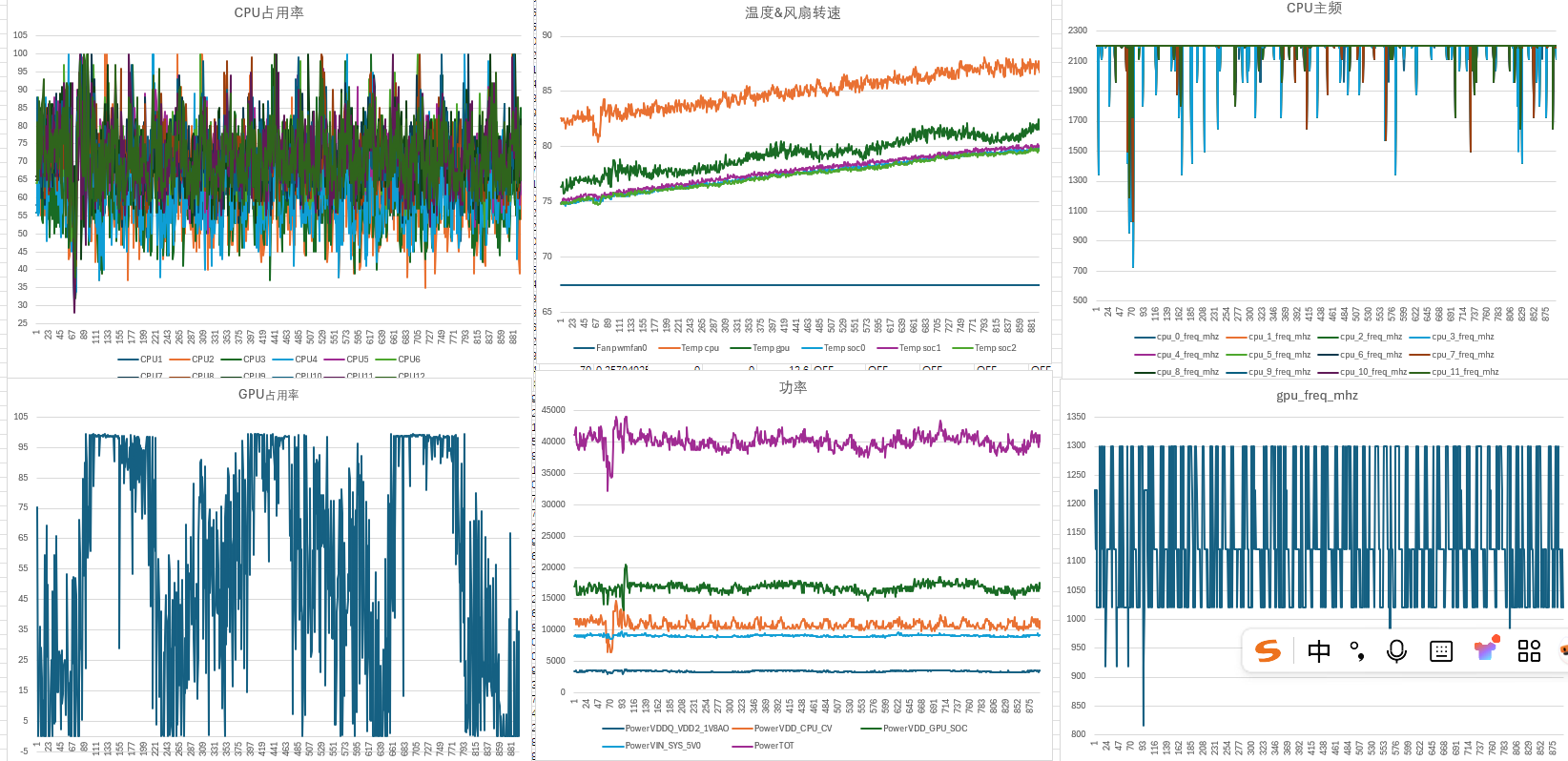

又复现了一次,产品在做完完整测试后,充电过程中,发生AGX突然断电
tegrastats_log截图如图
tegrastats原始log和串口log如附件,也没有看到异常值,串口log哪里体现出异常值了吗?tegrastats_log和串口log.zip (421.6 KB)。请协助分析关机的问题在哪里

From tegrastates info we recorded,temperature is below 90℃,not touch throtlling/shutdown trip point(99/10
3/104.5/105℃),Our thermal setting is the same as official file, we didn’t change.Do we need to. And power is around 40W, not exceed TDP. Why does the AGX oirn shutdown?

Do you know maximum TTP temperature from your thermal characterization?
