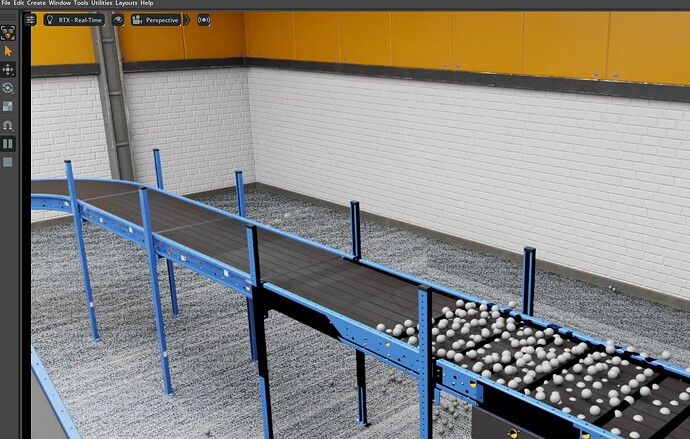

As you can see below screenshot. The particles penetrate the conveyor belt, also belt speed does not move the particles at all. Testing with a just normal cube with Rigid Body with Collider Preset works normally, but when I change them into the particles.
The fluid checkbox is deactivated and also tried couple of different physics settings but still not working.
Steps to Reproduce
  1. Create a conveyor belt with the extension.
  2. Create a cube with particle systems.
  3. Drop the cube on the conveyor belt.
Screenshots or Videos
Hi @hosei2, thank you for posting your issue. I think spawning normal prims seems to make sense in this application. What is the goal of using Particle Systems?
Thank you for the reply. The goal is to simulate mining applications, where sand or pebble stones are transported using the conveyor belt.
My first approach was to use Particle Systems to simulate these materials on the conveyor belt. Do you have any better approach you could recommend for this application?
One recommended method is to spawn Rigid Bodies with collider preset as you were doing originally. If you know ahead of time how many spheres you want spawn and you want them all at once, then Point Instancer is a good solution.
