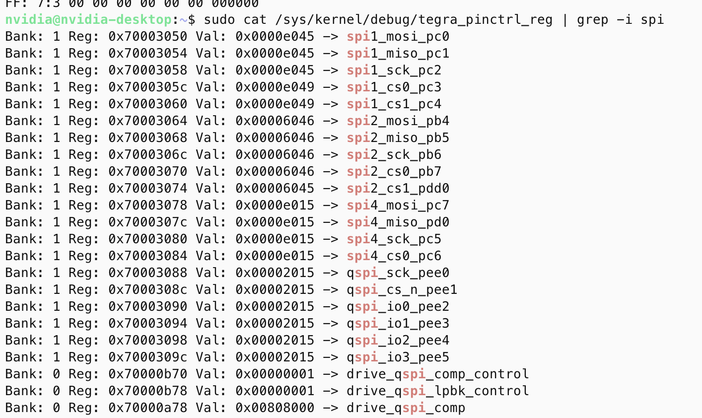

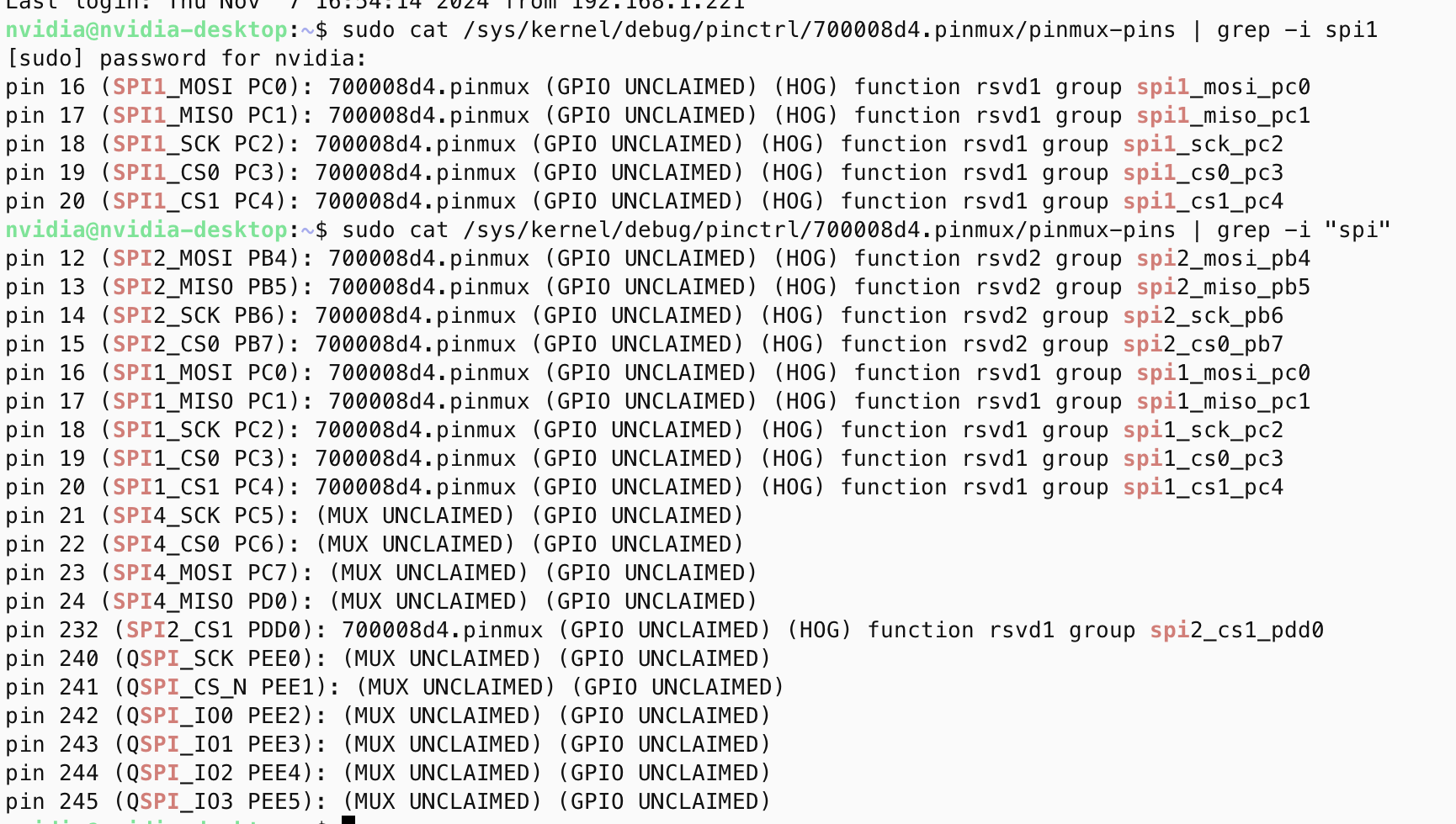

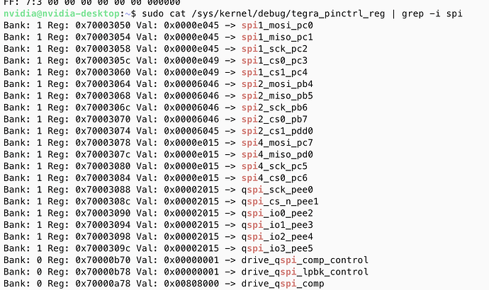

I have run commands to look at the pin configs. these are the results:
The SPI loopback test fails when I short pins 19 and 21, as well as 37 and 22. However when I bitbang these in GPIO mode the pins seem to work.
Many pins on a Jetson have multiple possible uses of which the device tree is responsible for determining the function. Since you have a custom/third party carrier board, this most likely means the manufacturer of the third party carrier board has a different layout compared to a developer’s kit. The software you get from NVIDIA is for a developer kit. The implication is that if the “correct” PINMUX spreadsheet is used (for a dev kit, which differs from a custom carrier board), or the “correct” device tree is used (which is what the PINMUX spreadsheet creates), then this custom carrier board will fail (at least for some components). You will have to get the information for this from the third party carrier board manufacturer since it isn’t possible for NVIDIA to know what carrier board layout has been chosen.
Sometimes a manufacturer of carrier boards will choose an electrical layout which matches a developer’s kit, but that does not seem to be the case for this. Far more often the manufacturer will provide either (A) a patch to the NVIDIA flash software, or else (B) a rebranded flash software which is basically a patched version of the developer kit software. To know which case you have you have to refer to the documentation from that manufacturer.
They are not the expected result to me.
Please share how did you configure them in pinmux spreadsheet.
