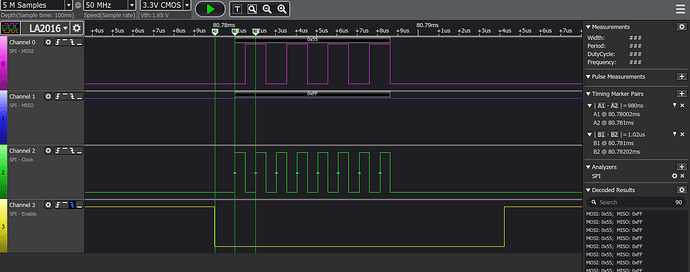

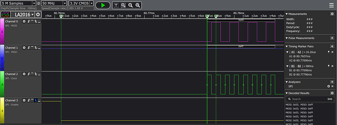

Hi guys,

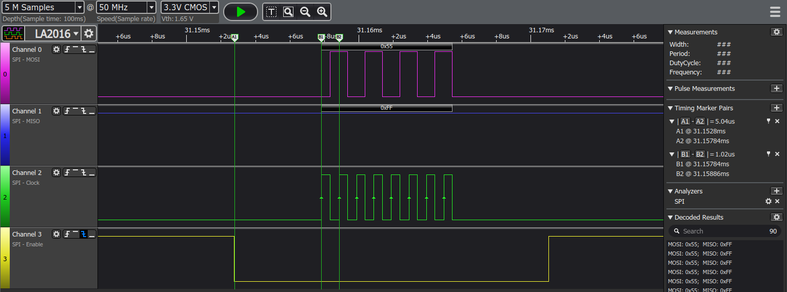

The MCU serving as a SPI slave is tested with a stm32 board. With SPI chip select to clock delay (CS delay for short) about 10ms on SPI master before transferring packet, the slave can receive data and ack data as required. But when SPI master switch to Nano dev kit,the MCU spi receives nothing except the second packet.

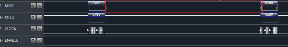

unchar def_tx[6] = {0x80, 0x80, 0x80, 0x80, 0x80, 0x80};
unchar def_rx[6] = {0xff, 0xff, 0xff, 0xff, 0xff, 0xff};
transfer(fd, def_tx, def_rx, 6);
//sc_delayms(2);
sc_debug("\n");
def_tx[6] = {0x81, 0x81, 0x80, 0x80, 0x80, 0x80};
sc_delayms(2);
def_tx[6] = {0x82, 0x82, 0x82, 0x82, 0x80, 0x80};

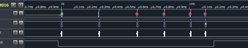

The slave can only receive the second transfer data 0x81, 0x81, 0x80, 0x80, 0x80, 0x80. We want to try to use the same CS delay to find out the problem. How can we set the CS delay prior to every transfer beginning?

But it seem the nvidia,tegra114-spi.txt have no CS delay property as what we need.
How could we settle this problem? Must we need to change the spi driver code?
