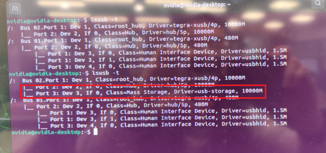

We are facing a frustrating USB3 Port deadlock issue on our custom carrier board (Jetson Orin Nano). The issue specifically happens with USB 3.2 Gen 2 (10Gbps) devices.
The Symptom: When we perform a “surprise removal” (physically unplugging) of a Gen 2 SSD:
No “USB disconnect” message appears in dmesg.
lsusb -t still shows the device as if it’s still connected.
The port becomes “dead”—plugging the device back in (or any other device) does nothing.
Our Workaround: We found that the hardware is actually fine because we can “revive” the port without a reboot by:
Manually toggling the authorized attribute: echo 0 > .../authorized then echo 1.
Or by unbinding and re-binding the 3610000.usb controller. After these steps, the port starts working again immediately.

Thanks for the suggestions. Given that our 10G SI measurement is verified PASS and the adapter test works (pre-establishing Host role), we suspect the port is falling into a locked state during a direct Gen 2 unplug.
Since our internal software resources are currently limited, could you please provide:
The Register Address: What is the specific address for the xHCI Port Status and Control Register to check the current link state? We want to see if the port is stuck in a “Disabled” or “Inactive” status after unplugging.
The Reset Logic: Where in the tegra-xusb driver is the link reset (Warm Reset) triggered when a Detach event is received from the CC logic?
Having these specific pointers will allow us to verify the hardware state immediately with a simple register dump.
Please find the attached relevant picture for your review.
The components used for CC Logic differ from the NV EVM, but the behavior is identical.
Cap TC5 on the VBUS path has been removed. When the USB is disconnected, the measured discharge time from 5V to 0V is approximately 6ms.
Deadlock issue is specific to USB3 Gen2 (Gen1 functions correctly). The F/R varies between 10% and 80%, depending on the connected device’s brand and model.
The issue looks to be in CC controller. We have FUSB301TMX on developer kit. Please check if your controller works identically. If behavior is different, you may need to modify device tree accordingly. Also removing cap TC5 may also have impact, if our developer kit has the capacitor.

According to the screenshot, an abnormal behavior is observed when using a Type-C USB 3.2 Gen2 storage device. After unplugging the device, it is still shown in the output of the lsusb -t command.
Under normal conditions, the USB device should be removed from the system and no longer appear in the device list after unplugging. This behavior differs from the expected result.
Notably, when performing the same unplug operation with a USB 3.2 Gen1 storage device, this issue does not occur, and the device is properly removed as expected.
Based on the information I have reviewed, the behavior of the CC pins should not differ between USB 3.2 Gen1 and Gen2 devices. Therefore, the question arises as to which specific mechanism or signal is responsible for notifying the system that the USB device has been unplugged and confirming its removal.
Given this understanding, it is unclear why the device removal is not correctly detected in the Gen2 case during the plug/unplug operation, while the Gen1 device behaves as expected.
