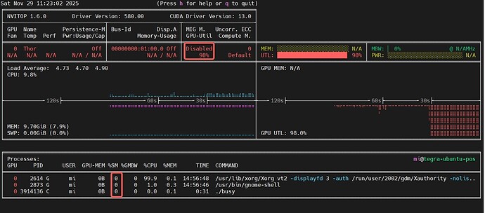

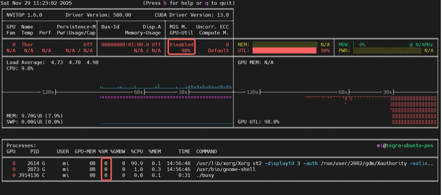

but if nvidia-smi pmon is not supported, we can’t get every process’s gpu utilization, it is hard for us to debug performance issue.
is there any schedule to support nvidia-smi pmon? or is there any other method to get every process’s gpu utilization?
nvidia-smi dmon only can get the total gpu utilization, but can’t get every process’s gpu utilization.
is it possible to use nvml api to capture every process’s gpu utilization?
The might be help. pip install nvitop
https://github.com/XuehaiPan/nvitop
thanks for your reply. nvitop is the same with nvidia-smi. can’t show every process’s gpu utilization.
Don’t know if this is granular enough, or absolutely correct values since Thor uses shared memory, but most recent version of jtop shows the total amount of memory for a process on 2GPU page.
Here’s jtop installation instructions.
yes, jtop can show every process’s memory info, the same as jetpack7.1’s nvidia-smi.
the current problem is we can’t get every process’s gpu utilization info.
