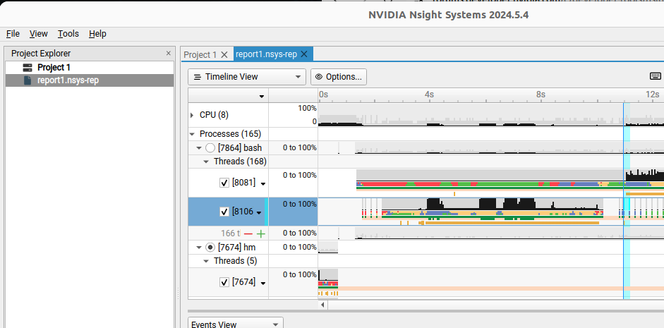

When I attempt to start profiling from the UI, I consistently get the error Target application XXX exited before profiling started.
I can run the profiling command on the target using nsys profile … then download the report file and display it in the GUI:
So I searched the forums and came across this thread here to capture a log and obtained the following file:
nsys-ui.log (43.6 KB)
All I see is that Deinitialize::start message but no error message.

When running from the UI, same error. The log shows message Skipping injection of myscript.sh process 6797 indicating that it finds the script and I’m configuring things correctly to run.
Only working case I found was using sleep 1000 as the command to profile (log shows it finds the binary as /usr/bin/sleep)
Can the tool be configured to be even more verbose?
