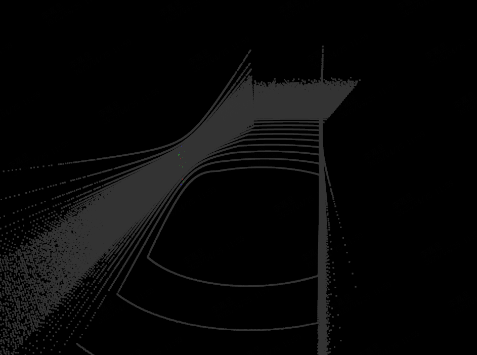

Hi zhengwang, thanks for your reply
I disabled warning and output pcd file with colors indicating different paths by code below:
import os

as you see only very few points have colors which means most of object id are not indicating the hitting prim.
RTX lidar is important for us because physx lidar can’t capture animated characters. Could you please help us to solve this issue?
Hi @fullike Have you tried running it longer and collect more data?
I changed if i == 100 to if i%100 == 0 and print the valid count at every 100th loop.
For some loops, there are not many valid counts, but for some loops it has decent amount of valid counts.
