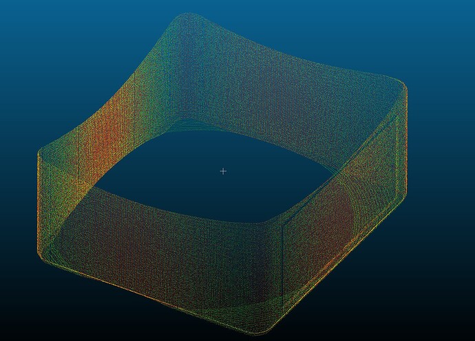

I am trying to obtain semantic point clouds from an RtxLidar. To do this, I have opted to use the “IsaacCreateRTXLidarScanBuffer” annotator and put it inside a custom writer.
When creating the sensor, I set “omni:sensor:Core:auxOutputType” to EXTRA, with the aim of being able to receive both the object_id and the material_id.
However, using the simple_room asset as a playground, the object ID it reports is always 0, while the material ID is 31.
Could you tell me what I am doing wrong so that I can obtain a point cloud where each point has the ID associated with the object?
I am attaching the code I am using to obtain this result:

The console output for the first 4 point clouds is as follows:
— len points: 130879
— intensities: [0.19400656 0.22205523 0.20438667 … 0.220394 0.2316678 0.21543679]
— timestamps: [ 4909147619709 11454677780337 18000207940965 …
70865220938743953 70871766468904581 70878311999065209]
— obj ids: [0 0 0 … 0 0 0]
— mat ids: [31 31 31 … 31 31 31]

Screenshots or Videos
Attached is the output of point cloud 4 (in CloudCompare), using the intensity value as the color:
Attached is the output of point cloud 4, using the object_id value as the color:

I created this same code in Isaac Sim 4.5 using “RtxSensorCpuIsaacCreateRTXLidarScanBuffer.” However, the problem is that in this case, the clouds are not complete, and the object_ids are not assigned correctly.
Thanks for bringing this issue to our attention. This is a known issue and we will have a fix for the future release. Please stay tuned.
This issue is fixed and will be released in Isaac Sim 5.1.0. Thanks for your patience!
