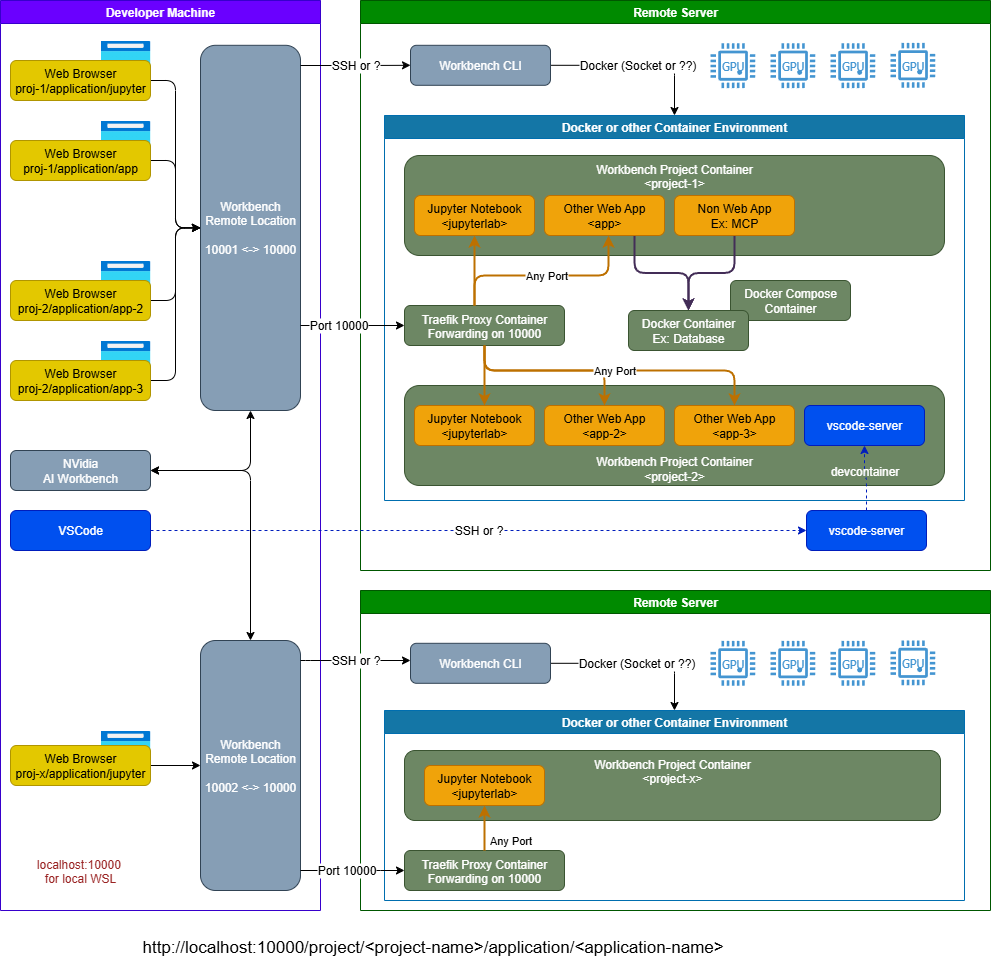

Looking at how to expose a Dash dashboard to the web browser from a Jupyter notebook. In my local machine, I have my Jupyter notebook start the Dash app server with an app.run()
Are container web apps remapped from their true local ports to be exposed on port 10,000?
This document Reverse Proxy and Networking — NVIDIA AI Workbench User Guide says that a traefik configuration is updated for any webapp. I’m assuming it is the port setting in the webapp that is fed to traefik`. Is that correct?
The proxy remapping is from container localhost:nnnn to AI Workbench hostlocalhost:1000/projects/.... as defined in https://docs.nvidia.com/ai-workbench/user-guide/latest/reference/proxy.html#configuring-apps-to-work-behind-a-proxy
In short, it depends. The way AI Workbench works is if you are working on your local location, all apps running locally (no matter the port) are routed using the following format on port 10000:
http://localhost:10000/project/project-name/application/application-name
This means for some app running on, say, port 3000, once added via AI Workbench it will be routed by the reverse proxy to port 10000 and differentiated by the project-name and application-name in the proxy prefix.
For remote locations, we follow the same logic, except the port number will change. For example, application X on remote location A could be accessible from:
http://localhost:10002/project/some-project/application/application-X
while application Y on remote location B could be accessible from:
http://localhost:10004/project/potentially-other-project/application/application-Y
This is how the reverse proxy differentiates between different apps running within different projects potentially across different locations. The local location is mapped to port 10000, and any remote locations are mapped to port 10002, 10004, 10006, and so on.
This is why the proxy prefix is important. By setting this value in the application, it can successfully run in such a way for AI Workbench to expose it properly. Provided is an example from the Hybrid RAG example project. If you can’t set this value, you also have the option to trim the proxy prefix before any requests are routed to the app.
Hope this helps!
This document says that a traefik configuration is updated for any webapp. I’m assuming it is the port setting in the webapp that is fed to traefik. Is that correct?
Your reasoning is accurate, when you add an app under Project Container > Applications > Add, you specify the port number that the app is expected to run on. This configuration for the webapp is forwarded and updated in traefik so it can handle routing the application properly.
