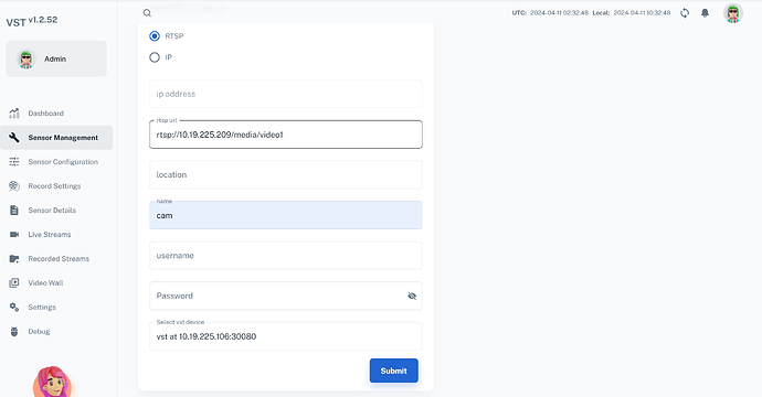

Unable to add RTSP stream to VST
I am trying to add an RTSP stream manually to VST as instructed in https://docs.nvidia.com/moj/nvstreamer/moj-nvstreamer.html#adding-rtsp-stream-to-vst
However, when I enter RTSP link and try to add the RTSP stream manually in “Sensor Management” tab it gives error that “Sensor Limit Reached”.
Can you please help me to rectify this error so that I can proceed with further steps?

Seems your RTSP URL is wrong, It is one .mp4 file. Can you share how you get the RTSP URL? Here is one sample video how to add RTSP URL: The deepstream-moj-app will show more and more grids after multiple camera addition/removal operations in VST - #4 by chiwen.lin . Please have a check it.
I have gone through the video, and I am also following similar steps to generate RTSP URL.
Following is a SS showing the RTSP URL I have generated by uploading the MP4 video to the NVStreamer:
Can you tell me is there any other steps that need to be followed to rectify the error I am facing?
Also, when I opened the VST Web server at http://[JETSON-IP]:30080/vst/ I see the following screen where instead of “Camera Management” and “Camera Configuration” tabs (as mentioned in the documentation), there are “Sensor Management” and “Sensor Configuration” Tabs:
Can this be a reason for errors I am encountering?

I have verified the VST v1.2.52. I can add RTSP URL in my side and I can get the right RTSP output from DeepStream.
