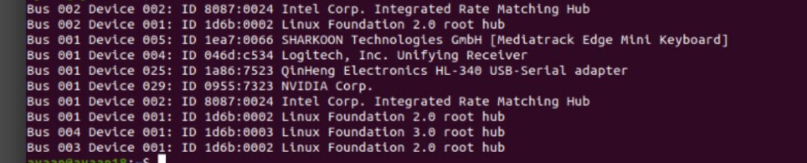

If the Force reccovery pin is not grounded the Orin NX is not detected by SDK Manager.
In case when force recovery pin is grounded and the device is powered the SDK Manager detects Orin NX the device is probably not it recovery mode as USB information does not show APX mode

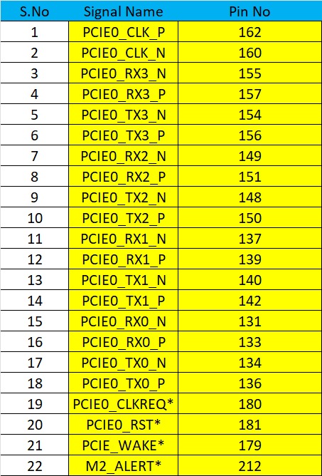

I have also included the Pin configuration used for PCIe in case of custom.

It’s showing 0955:7323 and it’s fine.
