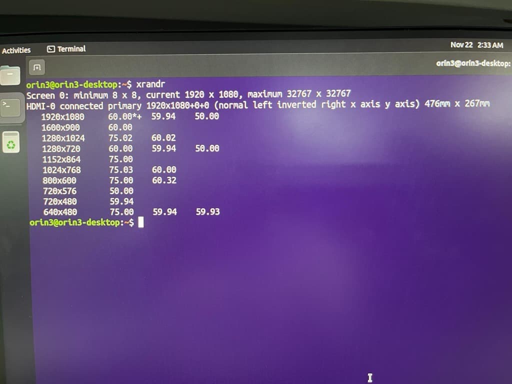

Could you share your xrandr result after you boot up into Linux for us to check if you really configure things correctly?
here is the xrandr result-
Looks correct.
