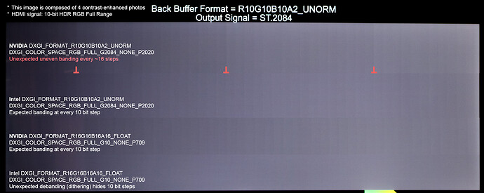

I am working on HDR output support in the Godot game engine and have come across an unexpected behaviour in NVIDIA Windows drivers that I cannot reproduce with other GPU drivers, such as Intel integrated graphics.
The issue that I am experiencing can be reproduced using an unmodified version of Microsoft’s D3D12 HDR output sample project. To reproduce the issue:
  1. Use a high-quality HDR monitor that supports 10-bit full range RGB, such as the Asus PA32UCDM
  2. Ensure HDMI output to the monitor is full range RGB, 10-bit HDR
  3. Run the sample project
  4. Press spacebar to enter full screen mode and use Pg Up / Pg Down to compare DXGI_FORMAT_R10G10B10A2_UNORM and DXGI_FORMAT_R16G16B16A16_FLOAT
  5. Note that uneven banding that is not related to 10-bit quantization is visible on the gradients with DXGI_FORMAT_R10G10B10A2_UNORM
  6. Press spacebar to leave full screen mode
  7. Note that the uneven banding is no longer visible, no matter what size the window is
I have also created a modified version of this sample project that makes the issue more visible. This modified version can be found here: GitHub - allenwp/DirectX-Graphics-Samples at banding-test-pattern
The following image shows four photos of different swapchain formats with NVIDIA and Intel drivers, showing that the issue is specific to NVIDIA drivers:
I have reproduced this issue on two different computers with Windows 11 Pro Version 10.0.26100 Build 26100 with an NVIDIA GeForce RTX 5070 Ti with these driver versions:
Game ready: 581.08 and 577.0
Studio: 580.97
