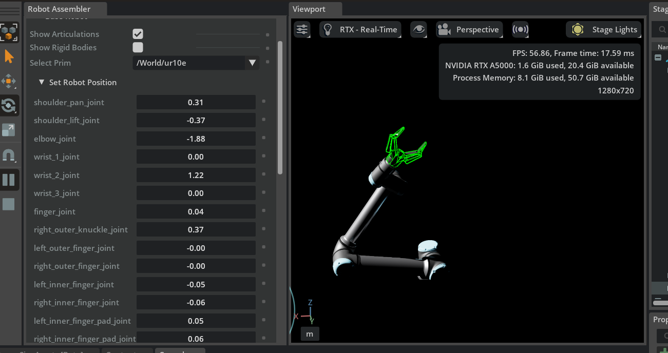

When using the robot assembler (tools > robotics > asset editors > robot assembler) with two official assets (a robot and a gripper from the assets browser), the simulation is very unstable.
Steps to Reproduce
  1. Open a new stage.
  2. Add a UR10e universal robot from the official assets browser (Robots/UniversalRobots/ur10e/ur10e.usd).
  3. Add a 2F140 Robotiq gripper from the official assets browser (Robots/Robotiq/2F-140/Robotiq_2F_140_physics_edit.usd).
  4. Open the robot assembler under tools > robotics > asset editors > robot assembler and assemble the robot and the gripper as follows:
  • base robot: /World/ur10e
  • attach robot: /World/Robotiq_2F_140_physics_edit
  • Base robot attach point: /gripper
  • Attach robot attach point: /robotiq_base_link
  • Click on assemble
  1. Play the simulation and observe “exploding” behavior (see video attached) where the arm is moving randomly ?!? and the gripper detaches itself.

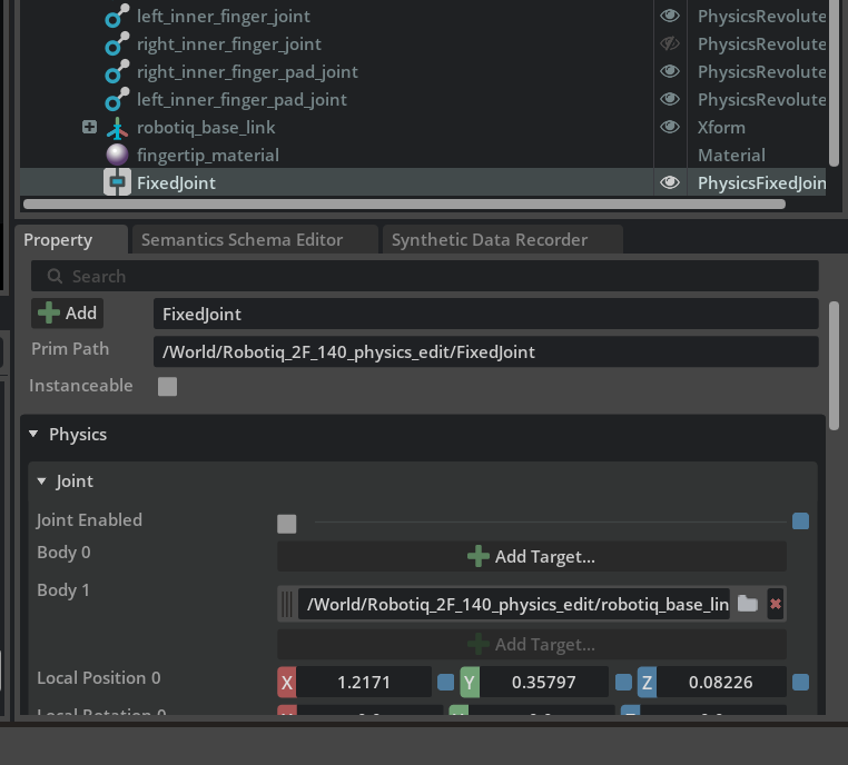

  1. The first modification you need is to fix the gripper by adding a PhysicsFixedJoint on it. Because the robot assembler performs robot assembling during playing time, a fixed joint prevents it falling to nowhere. Some other hands, e.g. the Allegro hand has a fixed joint on the root and it has no problem.
  1. When Assembling the robot using the assembler, you may notice that the /gripper xform doesn’t connect to any other part. We can change it to /World/ur10e/wrist_3_link to keep the articulation structure
  1. Finally, you can following your previous steps to make a stable assemble. I believe this bug is specifically related to these two assets, but you may encounter more as due to different asset formats.

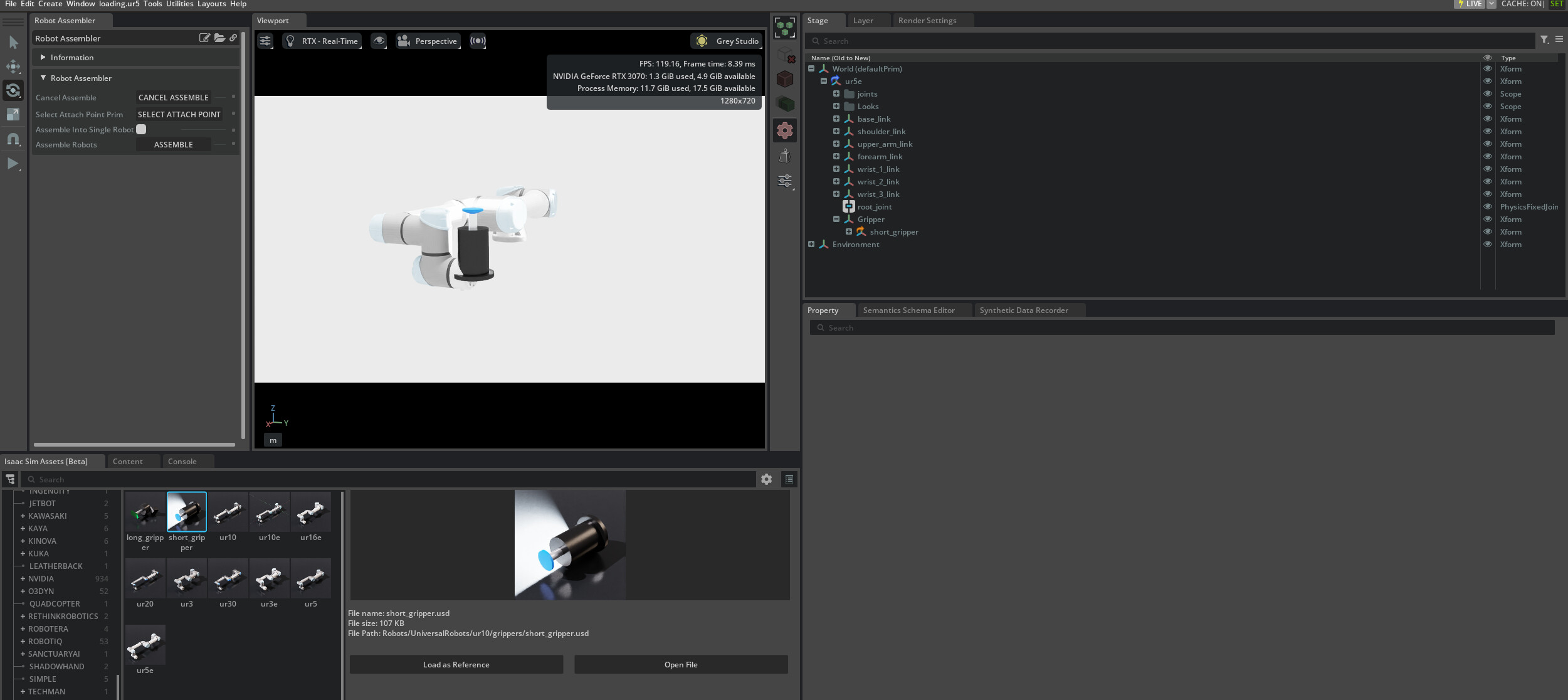

This issue occurs even when using the short gripper attachment available in the asset list. I encountered the problem while trying to attach it to the UR5e.
I’m currently following the importing a manipulator guide to set up a basic pick-and-place task. While I was able to successfully replicate the tutorial with the cobotta_900 robot, I’m now trying to apply the same process to a new manipulator — specifically the UR5e — which requires attaching a different gripper.
Unfortunately, the Robot Assembler fails at this step. I’ve attached a screenshot below showing how it breaks. Any guidance would be appreciated.
