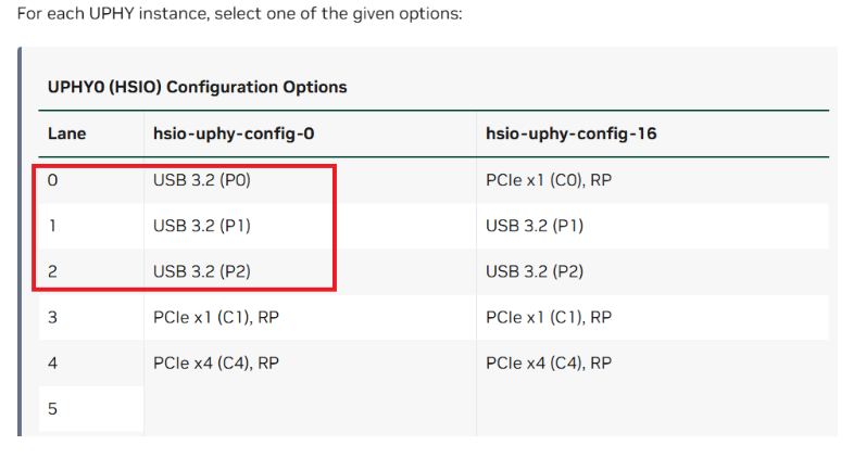

I still have some questions about USB DT:
  1. according to the diagram above, USB 0 goes with UPHY lane 1, while USB1 goes with UPHY lane 0.
    But according to the development doc:
USB0 goes with UPHY lane 0, and USB1 goes with UPHY lane1, instead.
Isn’t it conflicted ?

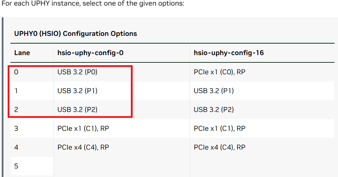

Because your understanding to the device tree is incorrect…
The document is all correct.
This means USB3-0 (P0) is with usb2-1.
Your understanding to this picture is also incorrect.
“P0” in this picture means USB3-0 in the device tree.
“P1” menas USB3-1.
It has nothing to do with what USB2 connected to. I mean this table does not indicate anything for USB2.

The problem here is you keep got misled by the Pin names of AGX Orin module and the SoC.
The mapping of usb3.2 (P0-P2) is a fixed thing. They are on the fixed UPHY.
You could read this table to understand this more clearly. Please make sure you don’t get confused by UPHY0 lane0-7 of the SoC and UPHY lane 0-20 of the AGX module
For example, USB3.2 P0 is usb3-0 in the device tree. For Soc, it is UPHY0 lane 0 and for module, it is UPHY0. And USB3.2 P1 is usb3-1, UPHY0 lane1 and UPHY1 for module.
