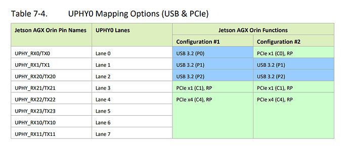

UPHY0:
  • The USB3.2 (P0) port on lan0 only functions as USB 2.0. I have configured it using Configuration #1 from the design guide, which should enable USB 3.0.
  • File: p3701.conf.common:
Configuration Used: ODMDATA="gbe-uphy-config-22,hsstp-lane-map-3,nvhs-uphy-config-0,hsio-uphy-config-0,gbe0-enable-10g";
 Above is the table from the Jetson-AGX-Orin-Design-Guide_DG-10653-001v1.7

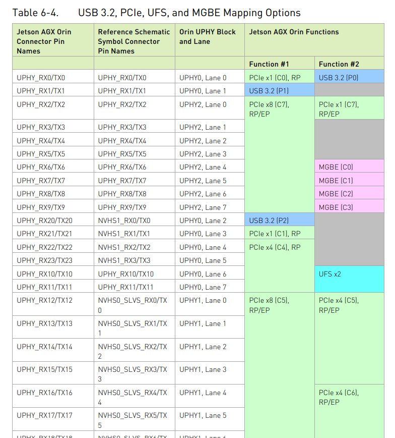

UPHY3:
I tested both the MGBE interface (Lane #6) and Minicard (PCIe via Lane #0), and both work simultaneously. While this is great, it’s unexpected based on the restrictions outlined in the v1.7 Design Guide, where this combination shouldn’t be valid.
 Above is the table from Jetson-AGX-Orin-Design-Guide_DG-10653-001v1.7
Interestingly, this behavior aligns with an older version of the design guide (v0.2 – Jetson_AGX_Orin_Design_Guide_DG-10653-001_v0.2), which allowed per-PHY configuration and supports the scenario I’m seeing.
Above is that table from Jetson-AGX-Orin-Design-Guide_DG-10653-001v0.2

I am not sure what is that table v0.2 you are sharing . For example, Orin AGX does not have C6 PCIe enabled at all.
Are you sure you read the correct document for Jetson Orin? What link are you using to get that documentation? This kind of document has obvious mistake that should be removed.
Please be aware that what you are doing now have been validated by many other users for like 2~3 years. The default behavior won’t be wrong.
You should read adaptation guide for modifying the device tree for PCIe and USB.
