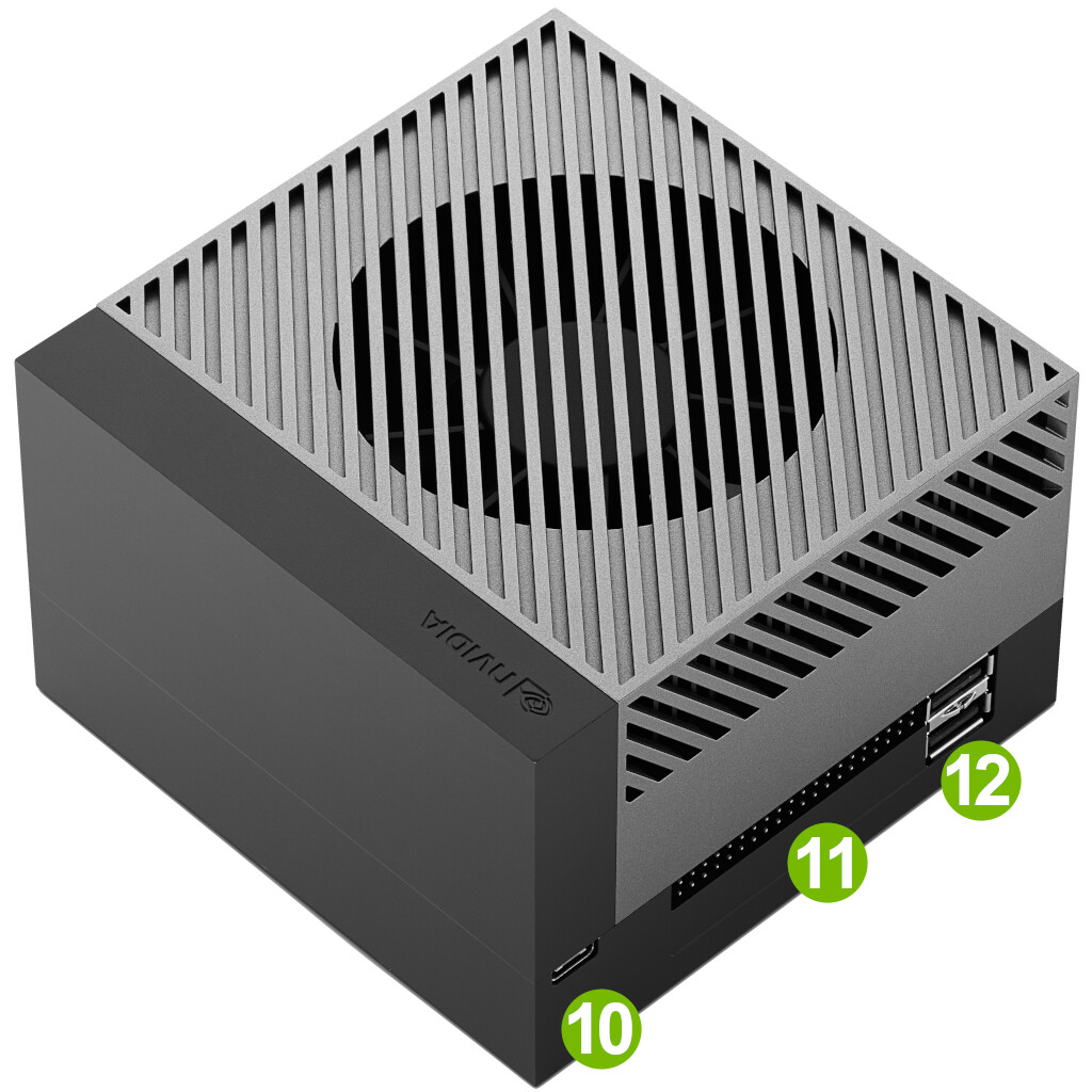

I want connect to PC with ORIN.
But It’s not working now. (Xavier is ok.)

- Orin boot log:
[ 13.922383] nvethernet 6810000.ethernet eth0: Link is Up - 1Gbps/Full - flow control rx/tx
[ 14.614357] ucsi_ccg 1-0008: failed to reset PPM!
[ 14.614598] ucsi_ccg 1-0008: PPM init failed (-110)
