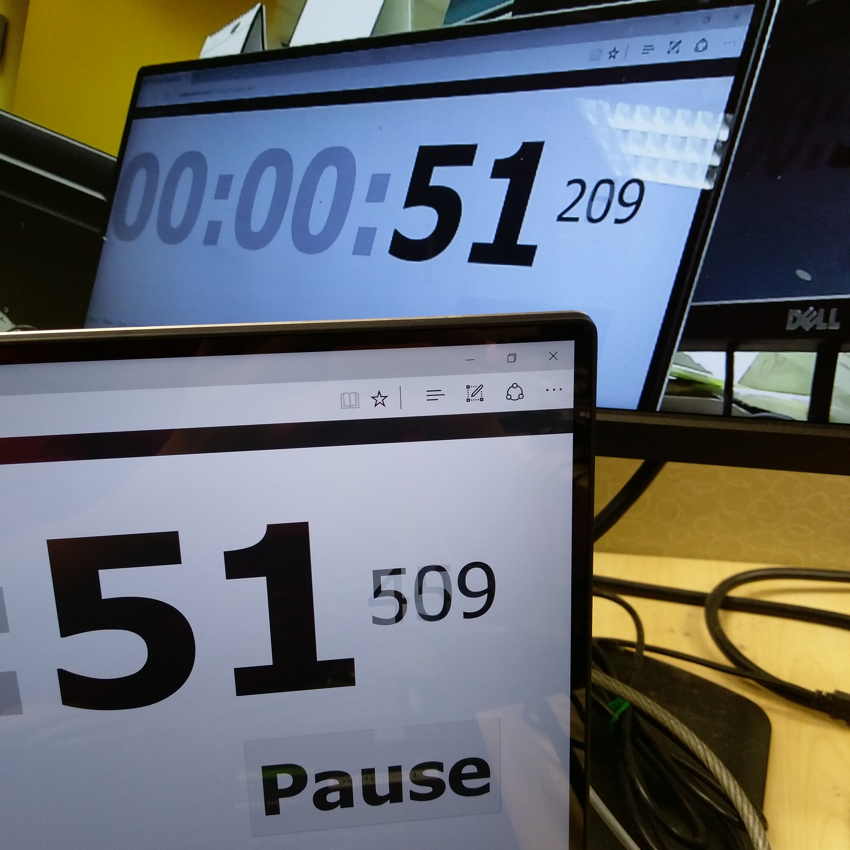

Hi mescarra,
We try with See3CAM_CU135 and see 9-frame latency(300ms) on r28.1(Kernel 4.4):
nvidia@tegra-ubuntu:~/tegra_multimedia_api/samples/12_camera_v4l2_cuda$ ./camera_v4l2_cuda -d /dev/video0 -s 1920x1080 -f UYVY
Failed to query video capabilities: Inappropriate ioctl for device
libv4l2_nvvidconv (0):(774) (INFO) : Allocating (4) OUTPUT PLANE BUFFERS Layout=0
libv4l2_nvvidconv (0):(790) (INFO) : Allocating (4) CAPTURE PLANE BUFFERS Layout=0
[INFO] (NvEglRenderer.cpp:109) <renderer0> Setting Screen width 1920 height 1080
^CQuit due to exit command from user!
----------- Element = renderer0 -----------
Total Profiling time = 319.323
Average FPS = 30.0009
Total units processed = 9581
Num. of late units = 1188
The result may vary with different USB cameras. The UVC video driver is default in K4.4. Not sure but there might be room for improvement. Other users may share experience.
