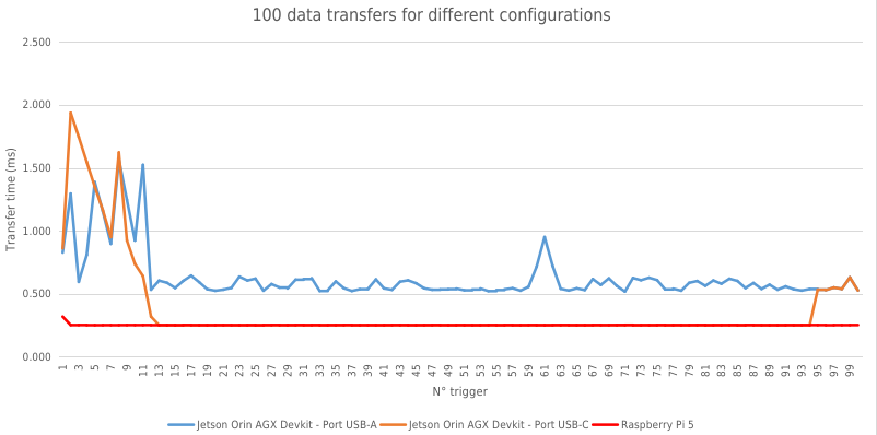

When I try 100 transfers without any applications running and with no other USB devices connected:
  • On any USB-A port: Nominal latency is unstable (around 0.6 ± 0.3ms) and there are some spikes up to a maximum of 4ms.
  • On the USB-C port: Similar behavior, but nominal latency is around 0.3ms.
I tried the same code on my PC (x86) and my Raspberry Pi 5 (aarch64):
  • On any USB-A 3.0 port: Nominal latency is very stable (0.25ms ± 0.001ms) and there are no spikes.
I tried changing my process priority, installing PREEMPT_RT, and setting the power mode to MAXN, but nothing changed.
Are there any specific configurations to apply in Tegra that I might have missed ? Or is this a hardware limitation ?

I use the FTDI API to send a read request (FT_ReadPipeAsync()) to the chip and receive the 100KB of data generated by the FPGA every millisecond. To measure the transfer time, I have a flag in the FPGA that rises when all 100KB of data are pushed into the FTDI FIFO.
For 100 transfers :
For 1000 transfers :
I repeated this test 10 times and always got the same result: spikes on the first transfers on the Jetson, but not on the Raspberry Pi 5. I would like to understand why.
I don’t have any other logs; I can only observe the latency fluctuations between each request.
It seems like the USB on the Jetson has a “sleeping mode” or some other default configuration.

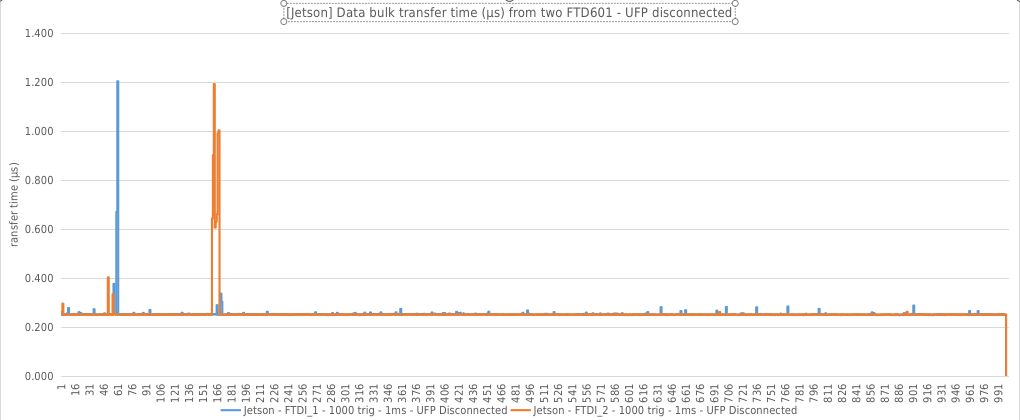

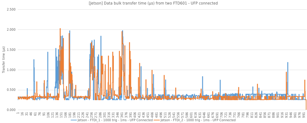

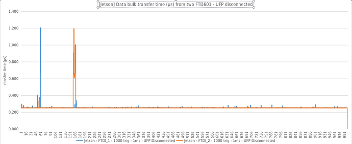

I conducted new tests with two FTDI601 chips that request 100kB of data every millisecond in separate threads. I observed significant performance differences when plugging or unplugging the UFP port to connect to the Jetson via SSH from my host.
I still don’t understand why the Raspberry Pi 5 and my PC have better performance for these transfers.
Is it related to hardware or software configurations ?
Thank you.
