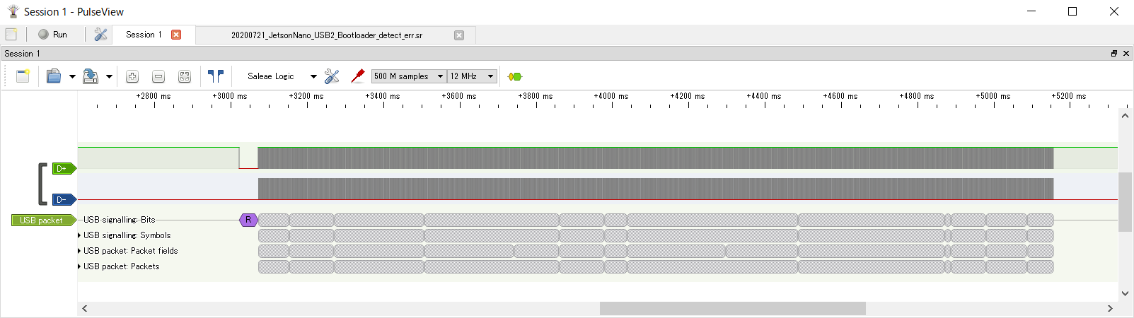

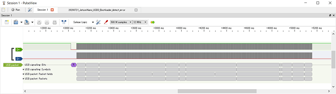

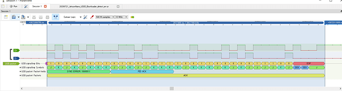

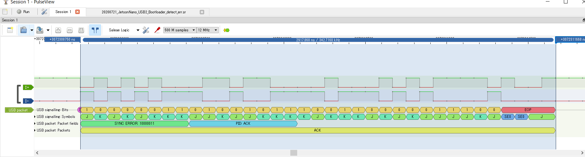

About this problem, we checked the waveform of USB D+/D- at the time of CBoot.
The pulse seems to be stretched out in some places like below.
OK
NG

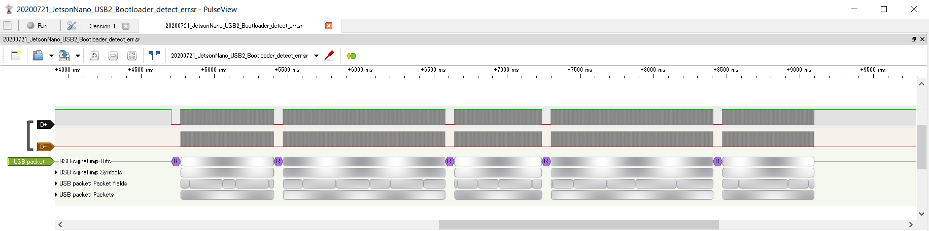

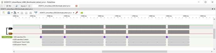

Also, it seems to be resetting the USB several times until it reaches timeout.
OK
NG
Could you tell us how we should address this issue?
