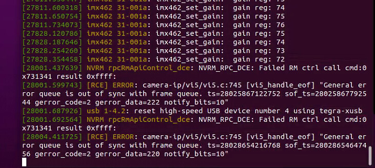

Use argus to capture the image ,sometimes stopped with RCE error log
error log : [RCE ERROR]: camera-ip/vi5/vi5.c:[vi5_handle_eof] “General error queue is out of sync with frame queue. ts=2181339514016 sof_ts=2181340183936 gerror_code=2 gerror_data=400062 notify_bits=0”
we used R35.3.1 argus to capture the image and one camera is 4k@60fps (lane rate over 1.5G),the other is 1080P@60fps
This error occurs from time to time, somtimes several hours ,sometimes over 48 hours
we have boost the clk ,but still exist this issue .
can you offer us some advice or have you met this issue before? thanks in advance.
when this error occured ,the argus freezed and we can’t quit the argus app

upload another condition which also show the same log ,when we just plug in a usb device .

Enable the trace log to check if any clue.

  1. boost the clocks to try.

  1. Confirm if below command have the same problem.
v4l2-ctl -c byoass_mode=0 --stream-mmap

Replace the lib at /usr/lib/aarch64-linux-gnu/tegra/libnvfusacap.so to try.
libnvfusacap.so.35.3.1 (193.6 KB)
We replaced the new file ,it seems to become stable ,but still stoped after seven hours. error log shown as above.
another problem is that we can only open argus one time after power on , even we killed the argus process ,we must restart the board.
Restart the daemon by command. (sudo service nvargus-daemon restart)
Please update to r35.4.1 to try.
you mean just replace to R35.4.1 argus ?
