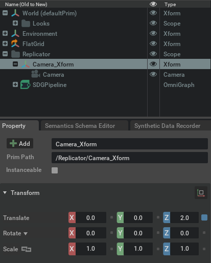

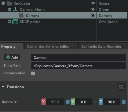

Hi @mati-nvidia . I’m currently using isaac sim 2022.2.0. With the code “camera = rep.create.camera(position=(0.0, 0.0, 2), rotation=(0, 0, 0))”, we could find that the camera instance is created and the translation and rotation of the Camera_Xform is defined as what we expected. But if you go into the Camera instance under the Camera_Xform, you could easily find that the rotation is 90,0,90, which may lead to a wrong rotation, because the created camera has rotated twice.

I believe this might be due to your world-up being different in Isaac Sim than the default Omniverse/USD UpAxis.
When the UpAxis is different, Replicator will apply a 90 degree rotation so that the camera appears correct when viewed (camera frame up being world-up)
