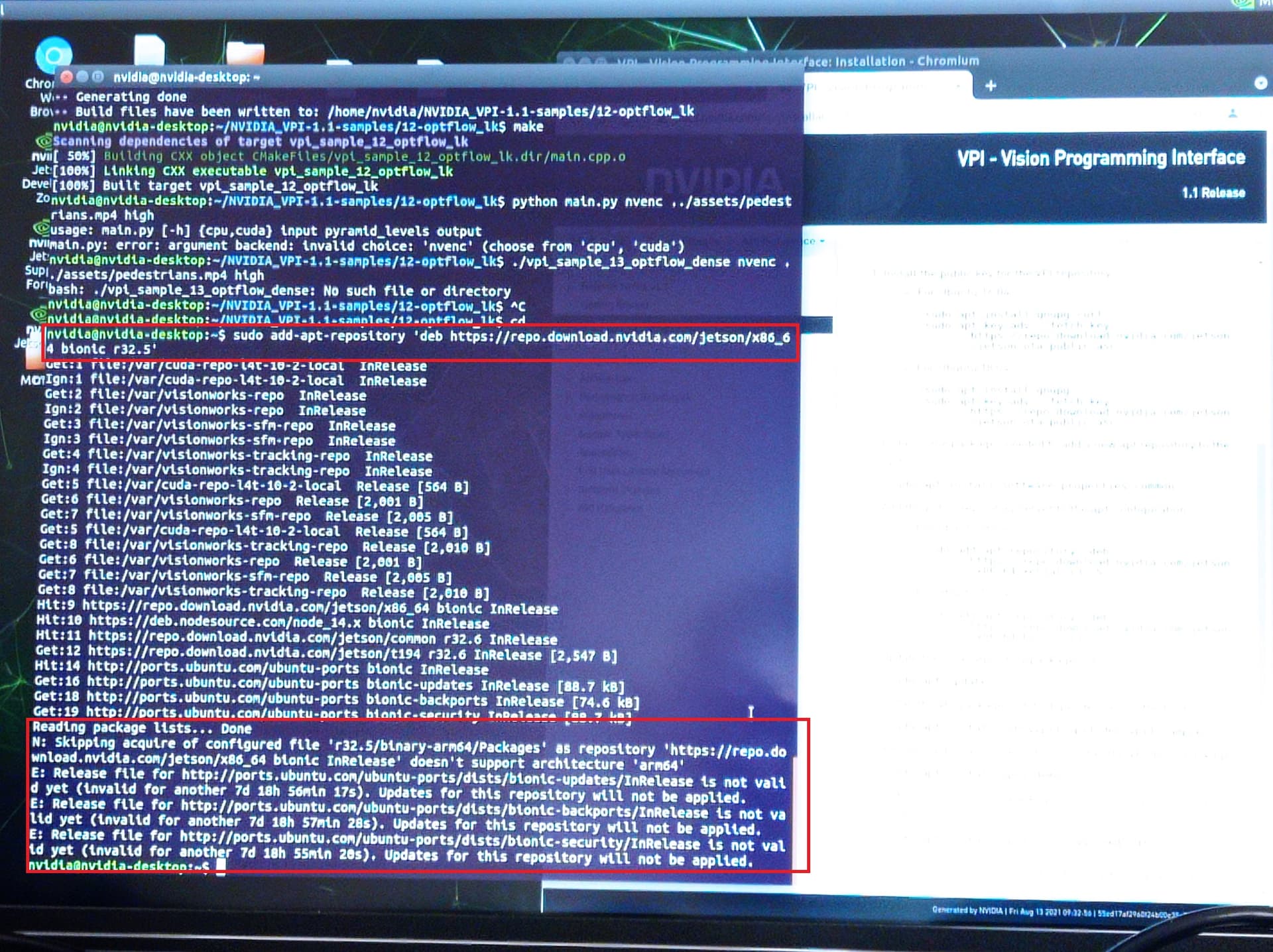

I follow this page for installation on my jetson NX (version: 4.6-b199, from sudo apt-cache show nvidia-jetpack)
VPI - Vision Programming Interface: Installation (nvidia.com)
The installation is ok until this line, and, the sample does not work… may I know if there is any solution? Thx
These are two different issues.
First, the vpi1-cross-aarch64-l4t is a cross-compiling package for the x86 host.
For Jetson, please install it with sudo apt install nvidia-vpi.
Next, which Jetson device do you use?
Please note that the dense optical flow feature is only available on the Xavier.
Do you meet the VPI error on a Xavier device?

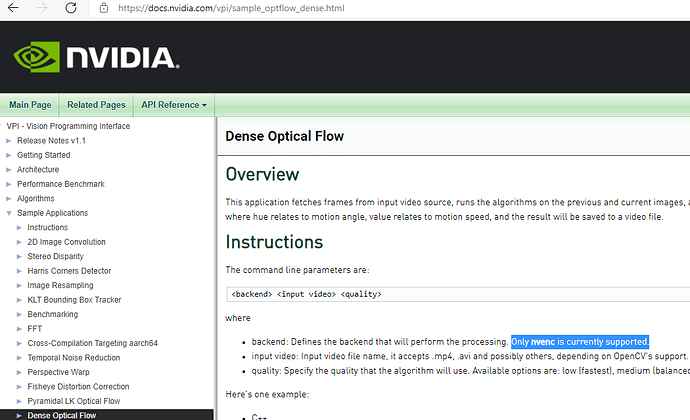

It seems optical flow can only be run in AGX… I have ordered a AGX two months, but I need to wait for 4 more months…
Is it the dead end? Thx
Please note that VPI is installed successfully.
The error is because that the dense optical flow feature is only available on Xavier.
