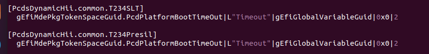

I found other 2 timeouts ,each need 2 seconds.
could you please tell me whether this timeout can be set 0 or not?
5 seconds you offered before is in file NVIDIA.common.dsc.inc
this file is Jetson.dsc.inc
That configurations are both for internal platform.
whether they can be set to 0 or not?
It could be configured as 0 but it might not help to reduce your boot time.
