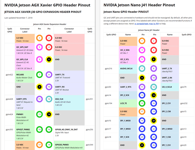

Why do some pins on the AGX Xavier show 1.8V/3.3V?
On the AGX Xavier some of the pins, which have the option of being used as gpio or pwm, (such as pin15) show the voltage as 1.8V/3.3V. Pin 37 is a gpio pin that shows 3.3V only.
Can I toggle this 1.8V mode to a 3.3V mode? I have not been able to use these pin for anything. I have tried using pin 15 as a gpio pin. I get nothing out of it. I have tried using pin 15 as a pwm pin after setting it to pwn with sudo /opt/nvidia/jetson-io/jetson-io.py . I get no signal out of it. I connect an electrometer to the pin during the attempt at gpio and during the attempt at pwm. I get no change in voltage out of it. The voltage seems to be at 0.1V or 0.3V with no changes.
AGX Xavier pins
Nano pins
When I set pin 15 to pwm and run a program that is supposed to send a pwm signal through pin 15 I expect it to move the motor and to have a specific signal of voltage out of the pin when I touch the electrometer to the pin.

I tried the solution to a similar question here. It leads to a pdf which says “$ cat /proc/device-tree/nvidia,dtsfilename
If the file name is tegra210-p3448-0000-p3449-0000-a02.dts, the version is a02. If it is
tegra210-p3448-0000-p3449-0000-b00.dts, the version is b00.”
When I typed $ cat /proc/device-tree/nvidia,dtsfilename
I got
/dvs/git/dirty/git-master_linux/kernel/kernel-4.9/arch/arm64/boot/dts/../../../../../../hardware/nvidia/platform/t19x/galen/kernel-dts/common/tegra194-p2888-0001-p2822-0000-common.dtsi
It was the bridge for the three pins under the device. j514. When 1 and 2 are bridged it is 3.3. When 2 and 3 are bridged is it 1.8.
