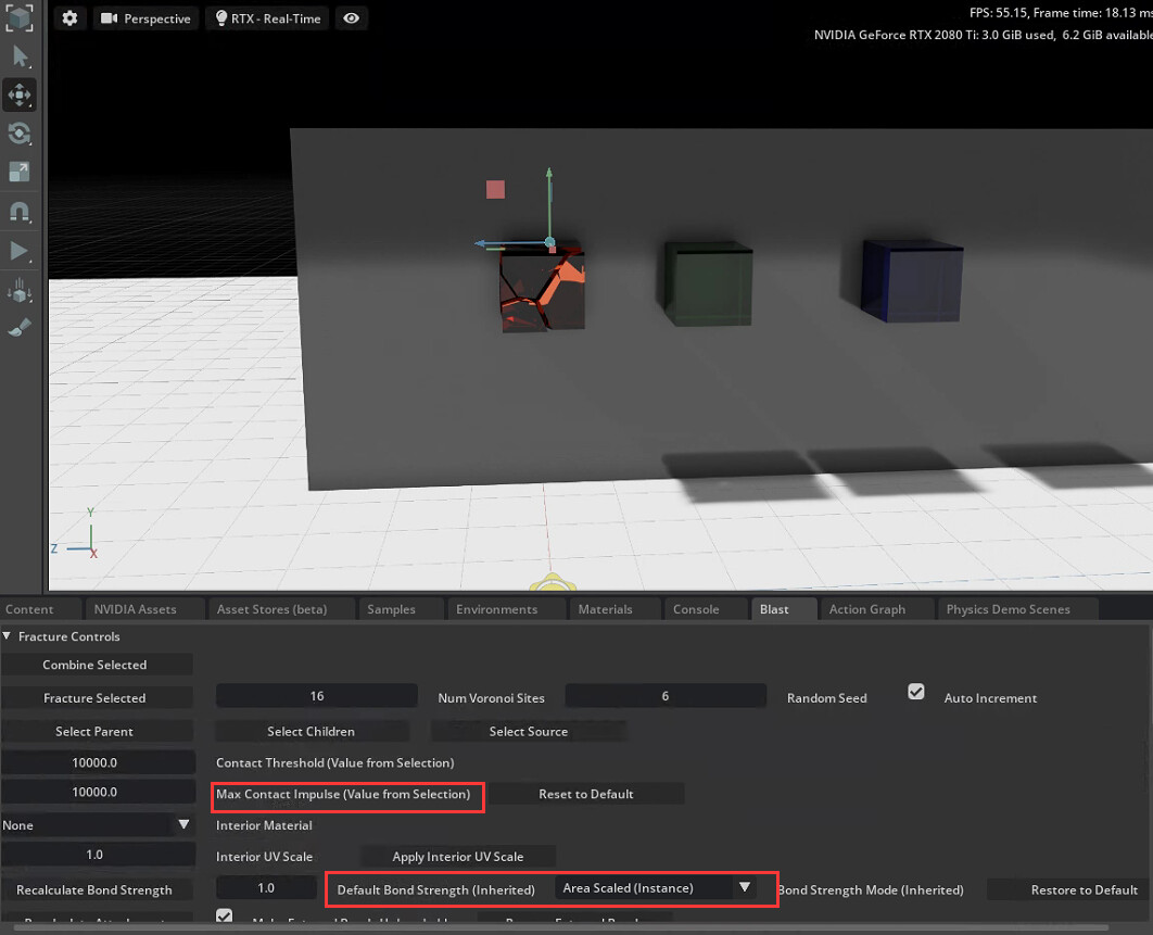

Hi, there is another question about using the Blast extension when I checking the blast examples. How to add the unbreakable bonds within two meshes? I noticed that the cube which has unbreakable bonds with the wall has different Contact Threshold, with “value from selection” in parentheses, and the other cubes that has breakable bonds with the wall is “value to be applied” in ( ). Also with the Default Bond Strength, one cube may have “inherited” following it, one may don’t have. I don’t know how to set it, for I’m so new to using omniverse.
Any advice would be appreciated!
Cheers!

For bonds, the blue cube has a different label because it doesn’t have bonds with the wall. It will fall if you press play. The red cube has unbreakable bonds with the wall, the green cube has breakable bonds with the wall.
Whether they are breakable or not is controlled by the checkbox next to “Recalculate Attachment” a little farther down in the panel. Checking that box will make the bonds between the destructible and world geometry unbreakable, unchecking it will set the bond strength to be the area between them.
Hope that answers your question there. I’ll let you know if I can find any answers to the issue you are having with simulating fracture.
“Value to Be Applied” means that the selected prim doesn’t have it set. We should come up with a clearer way to message that. Since some of the UI values can be set before prims are combined/fractured and are used as initial values, we wanted to call them out differently than when we pull values from the selection. For the green and red cubes, if you change the value while they are selected, it will be stored on the prim. Changing it while the blue cube is selected won’t have any lasting effect unless you then press the “Recalculate Attachment” button, then the current UI value is used.
Also, in case it wasn’t clear, the “Max Contact Impulse” is only used for destructible prims that are attached to static world geometry. That’s why the blue cube doesn’t have a value set on it. We tried to describe that in the tool tip if you hover over the “Max Contact Impulse” label.
