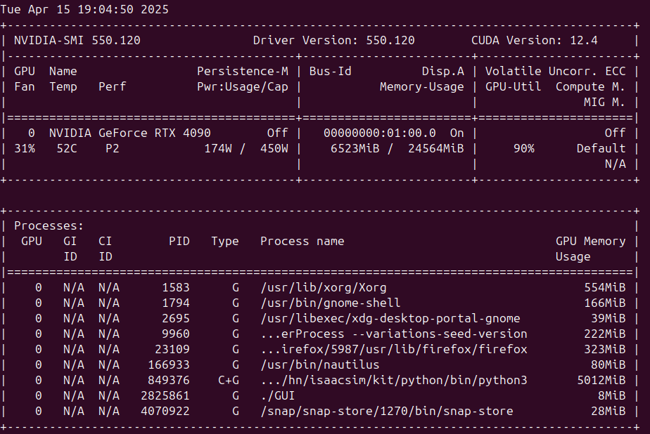

  • Are there specific settings (e.g., physics parameters, solver type, or GPU configurations) to ensure stable 500Hz physics updates, regardless of real-time constraints?
  • Could background processes (as shown in my nvidia-smi output below) be impacting performance, and how can I minimize their interference?
