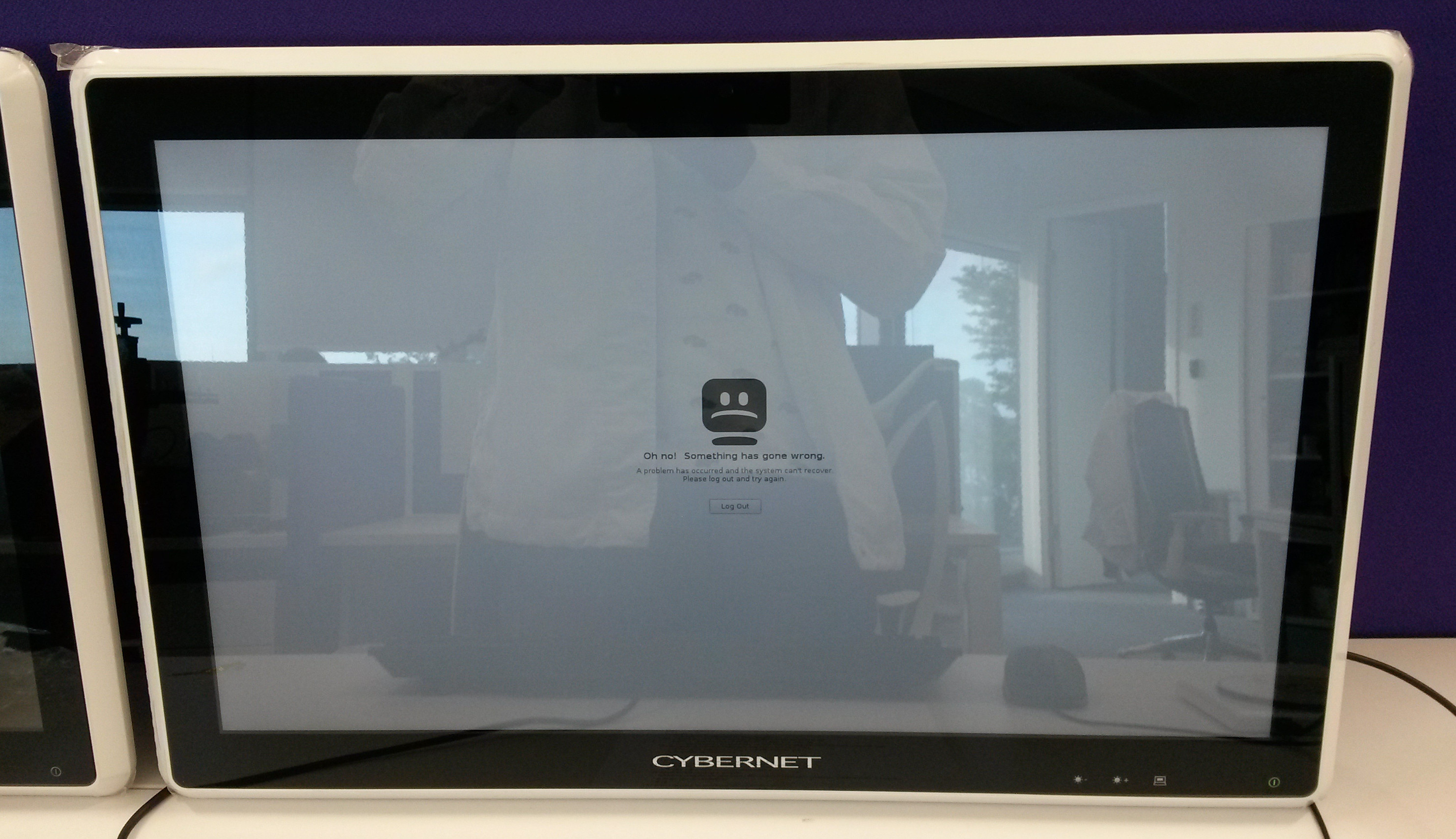

This PC has GeForce GT 720M. The installation of 381.22 was complete. No error was prompted. Yet, I noticed one different thing: the installer did not ask me whether to use NVIDIA X Config (later I did try to manually run “nvidia-xconfig”, but the problem still persisted). Then X Server (v1.17.2) could not start. The screen showed (see attacheded photo):
Oh no! Something has gone wrong.
A problem has occurred and the system can’t recover.
Please log out and try again.

This is laptop hardware, i.e. an Optimus system. You will have to configure it to use PRIME if you want to use the Nvidia gpu.
[url]http://us.download.nvidia.com/XFree86/Linux-x86/375.10/README/randr14.html[/url]
[url]https://wiki.archlinux.org/index.php/NVIDIA_Optimus[/url]
Otherwise, uninstall nvidia drivers and use intel gpu.
Dear generix,
Thanks for pointing this out! Unfortunately, Red Hat does not support Optimus system. I tried Suse, and it worked. Seems I have no choice but to give up Red Hat.
Thank you so much.
