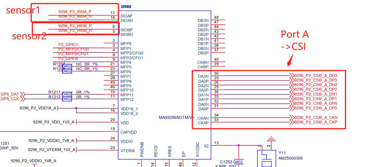

Xavier max9296+two 9295
I use Jetpack 4.4 kernel, use one max9296+two9295+tow imx390,
reference to the original driver,
The “/dev/video0” and “/dev/video1” nodes are successfully created, but the “/dev/video1” node still has no data,
some log as follow:

media-ctl -p -d /dev/media0
Media controller API version 0.1.0

use command “gst-launch-1.0 v4l2src device=/dev/video1 ! videoconvert ! xvimagesink&” ,just open “/dev/video1”(imx390 8-0012),not open “/dev/video0”(imx390 8-0011), and
cat /sys/kernel/debug/tracing/trace as follow:

Does it virtual channel design? Could be the virtual channel ID or the CSI/VI port configure incorrect.
Hi ShaneCCC,
   Thanks again!
Some detailed information is as follows.
Any suggestions are welcome!
  My schematic:
9296 port A:
My DTS:
