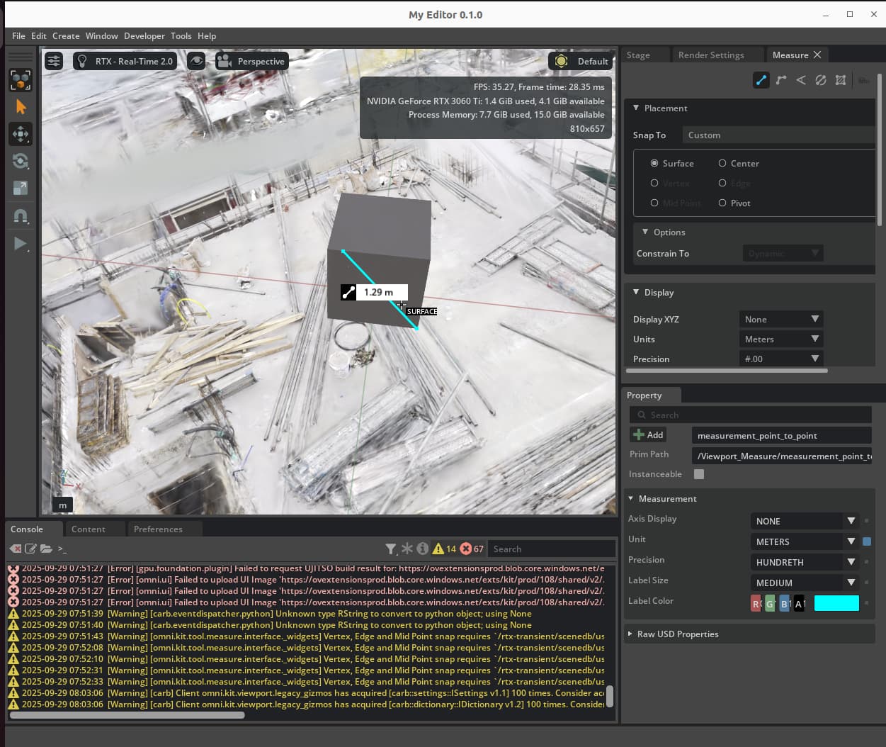

I am currently working on displaying 3D Gaussian Splatting (3DGS) results within NVIDIA Omniverse.
I successfully confirmed that assets processed using the
3DGUT approach (specifically, converting the 3DGS data to a USDZ file) can be imported into Omniverse.
However, when I attempt to perform a distance measurement directly on the imported 3DGS asset, the measurement fails or is not possible.
Conversely, when I create a mesh from the scene reconstruction and import that mesh, I am able to perform the distance measurement correctly.
My core question is this: Is it mandatory to convert the 3DGS representation into a traditional geometric mesh in order to enable distance measurement tools within Omniverse?
Any insights into the required data structure (e.g., volumetric particle vs. explicit surface) for enabling measurement capabilities in Omniverse would be greatly appreciated.

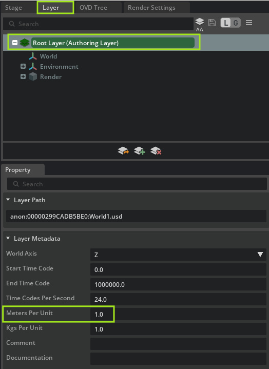

@leo94 just out of curiosity, what’s the measurement of the stage in the USDZ? more specifically the MPU of the stage, is it set to 1.0 or 0.01?
@Simplychenable
I’ve used the code straight from the 3DGUT/3DGRUT repo, so I suspect the MPU is 1.0 (Meters Per Unit = 1.0 meter).
How could this MPU value affect the measurement issue?
i presume it would affect the scale of your stage, along with the objects residing in the stage. the same cube will be off by 100 times if the MPU is incorrectly set up (especially so if you plan on referencing the stage without Metrics Assembler extension enabled). if you were to open up the USDZ and go to the Layer tab > LMB on the Root layer > and look at the MPU setting for the stage, what do you see?

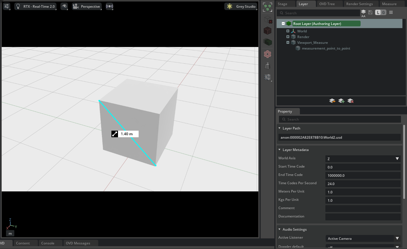

here’s another comparison. i created a cube prim in a stage where MPU = 1.0 (m). the resulting cube should have diagonal measurement of 1.4m on any given face.
however, if i were to switch the MPU to 0.01 (cm) and remeasure, the diagonal becomes 0.01m:

  1. Scale Information (MPU): We already use CCTAG (Circular Color Tag) markers to perform real-world scale calibration during the SfM (Structure from Motion) stage. Furthermore, the MPU (Meters Per Unit) is set to 1.0 (1.0m) when converting to USDZ. Therefore, I believe the issue is not with the scale itself.
  2. Core Question Reconfirmation (Representation): My core question is this: Is it true that Omniverse’s default measurement tools cannot measure distance on the Gaussian Splatting (USDZ/3DGUT) representation because its fundamental data structure is not an Explicit Surface like a Mesh, but rather a point cloud (Gaussian particle)?
  3. Alternative Question: Is converting the 3DGS data to a Mesh mandatory for measurement, or is there an alternative setting or extension within Omniverse that can enable measurement capabilities directly on the 3DGS data?
